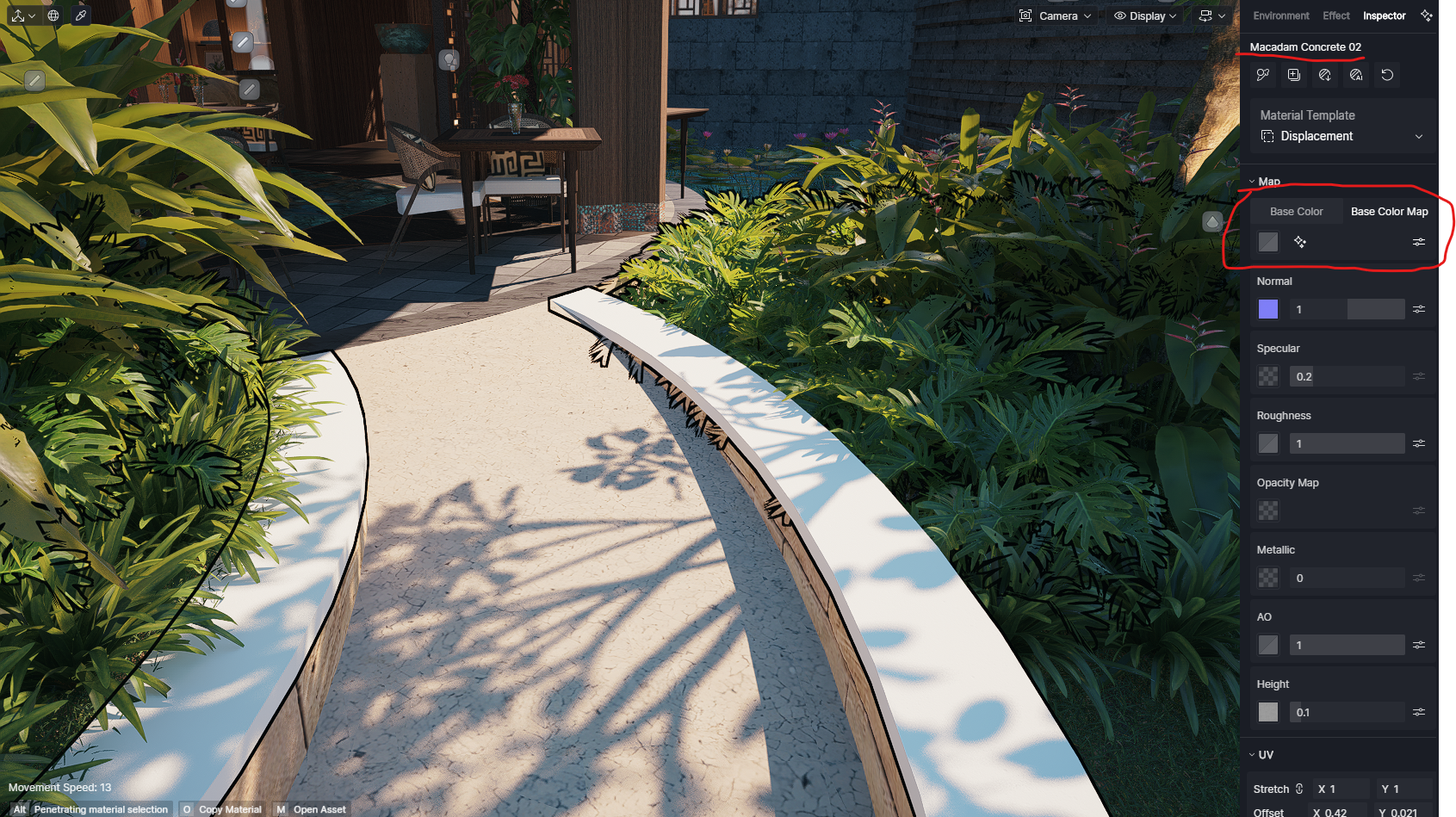

hi, i have problem with d5 material library, i use this material in my model, evrything is fine, until i open it again to making the revision, but the material is missing from the base colour, its weird, bcs is from material library, can some one halp me?
Screenshot 2026-06-12 214300

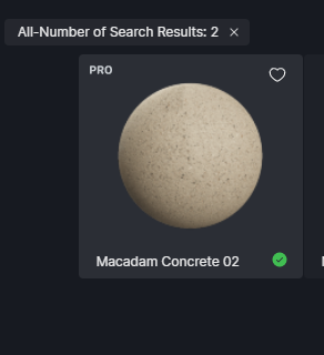

its missing and turn white, already try to add another material, and add the material again, its same

Hi @krisnayudi654
This only happens to this specific material and surface, right?
  • Were there any modification with your 3d Model? Specifically for this surface only?
  • How about your workspace folder? Where is it located?
Please note that your 3d Model File, D5 File, and D5 Workspace should be placed in your Local C or D drive to prevent material loss.
