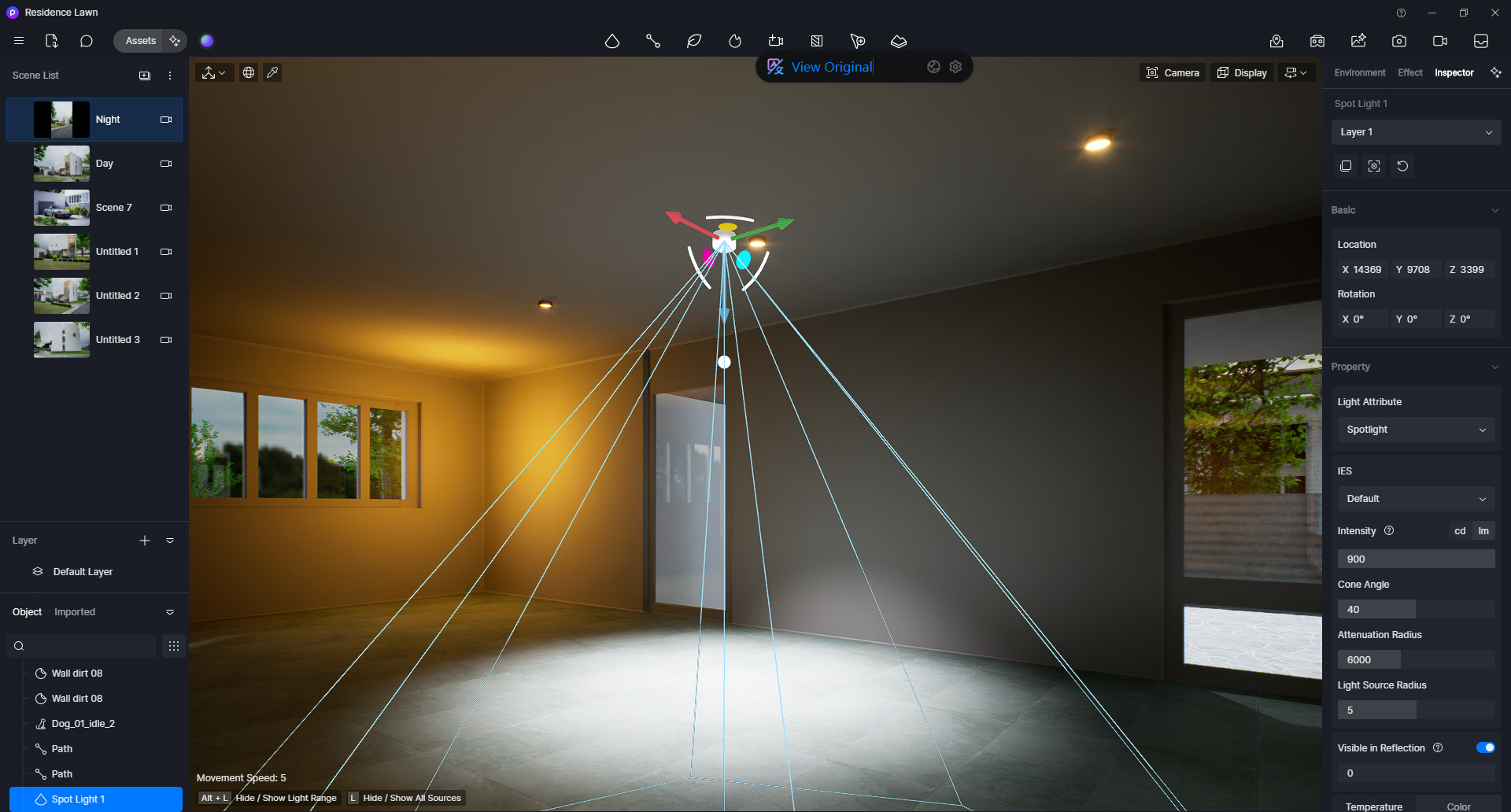

Exposure and Sunlight also plays a huge part in brightening the scene. You can set it the exposure to 0 or simply test it on a Night Scene so you can see how 900 lumens look like.
  • This is the test I made on my end using Residence Lawn, the room is quite dark and exposure is set to 0

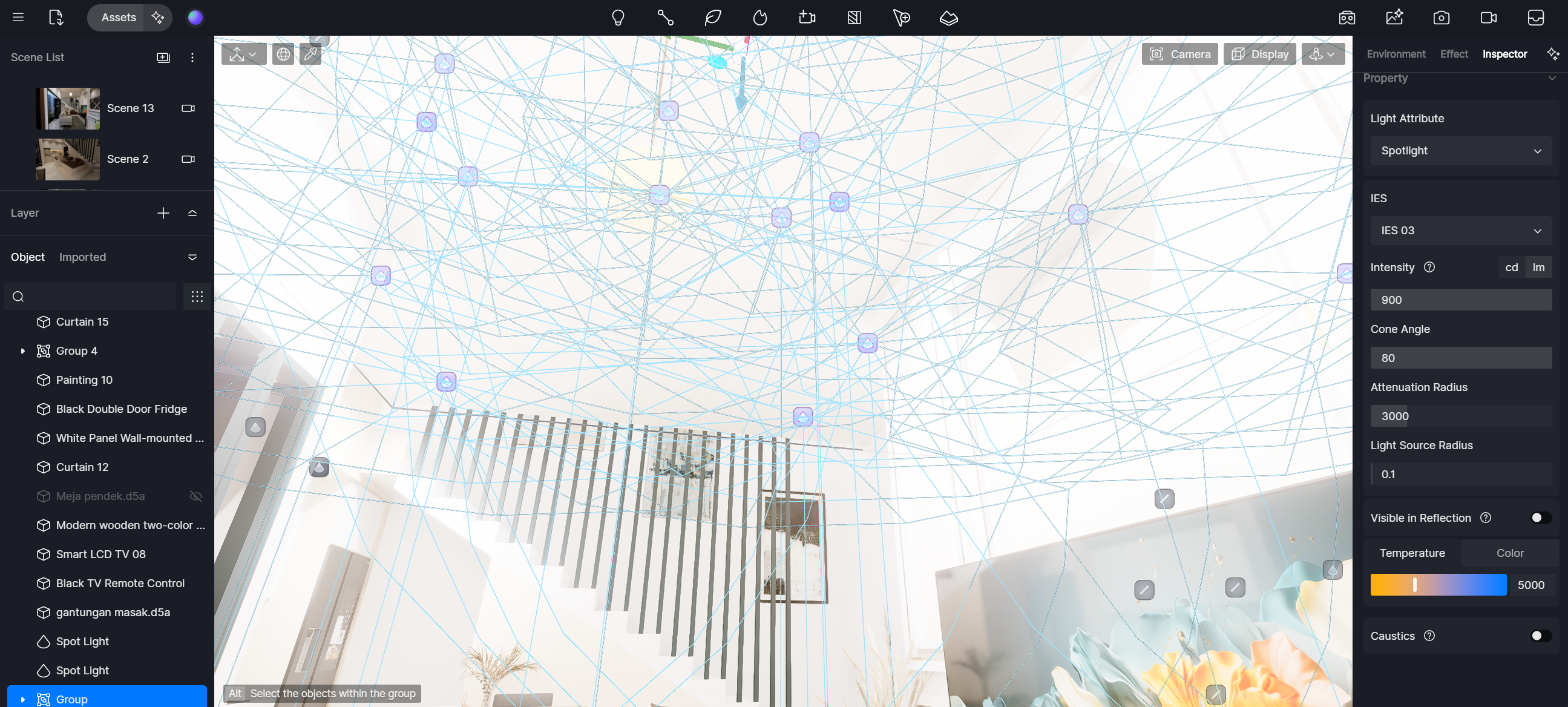

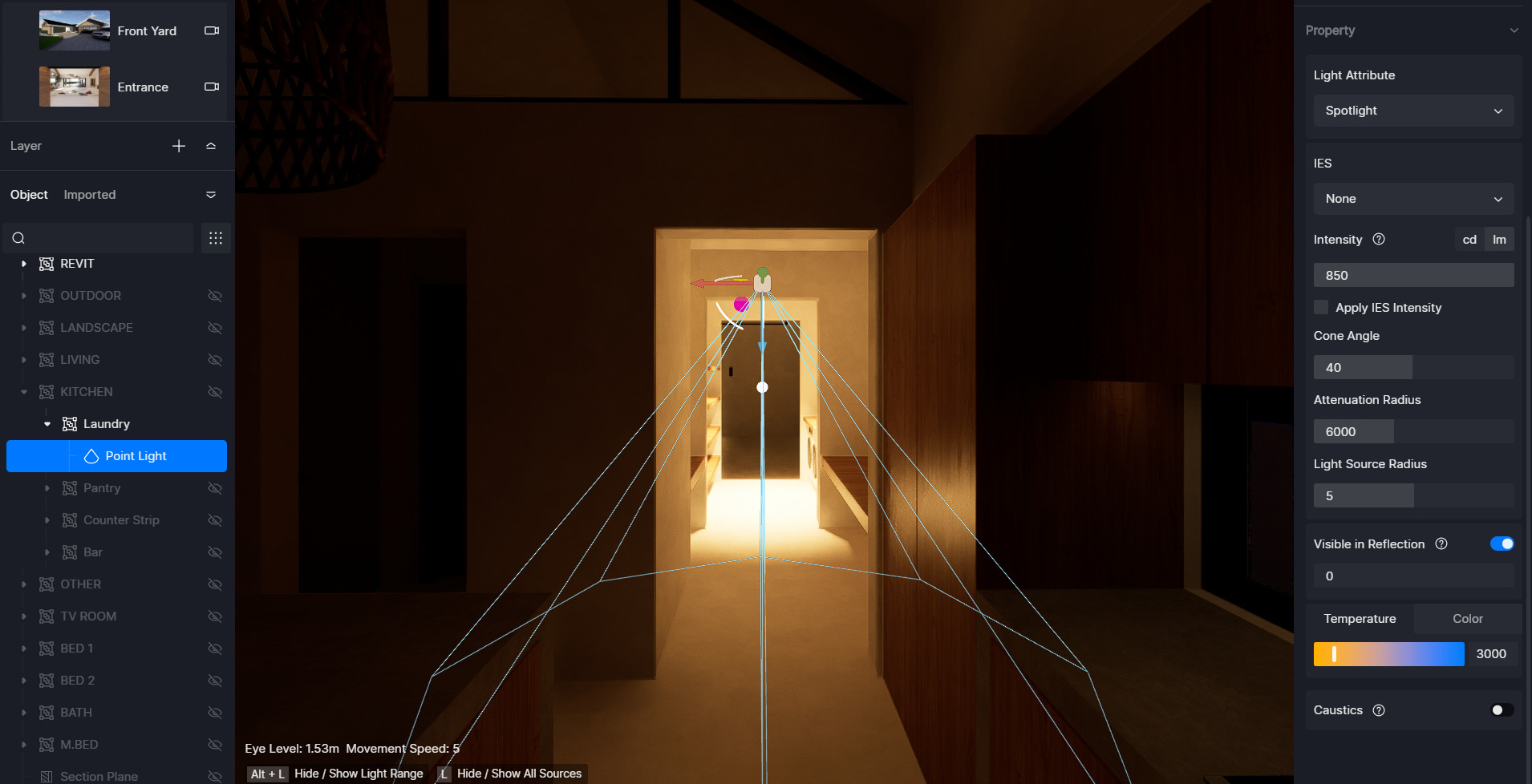

Hello @Clov,
I’m trying to recreate a realistic night scene using this downlight:
This is what I have so far:
I’ve input the same lumen value (850 lm) as the product specs, but my render is coming out unrealistically bright.

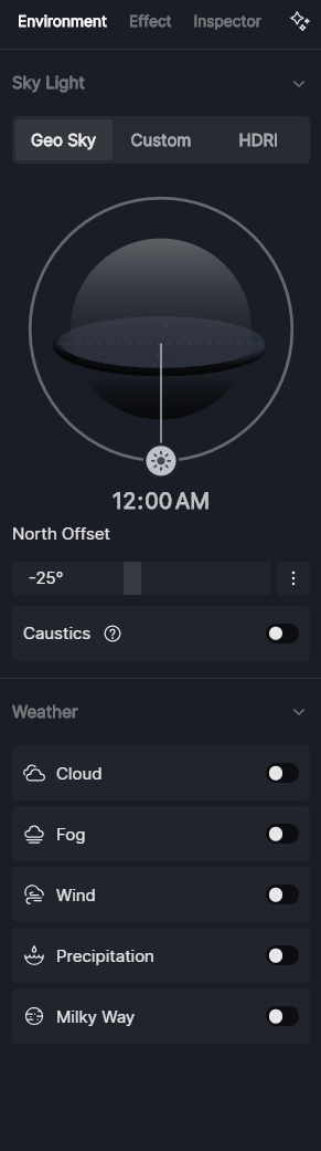

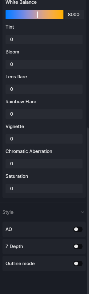

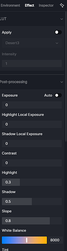

Here’s a screenshot of my current environment and effect settings:
Am I missing something or misconfiguring a setting?

Hi @minawr00
Our team has confirmed that the light assets themselves are accurate. However, the issue you’ve encountered is a known limitation where artificial lights appear overly bright due to our current sunlight system. This is a known issue, and it will be further improved in future version release.
For now, I suggest modifying the Environment or Effect parameters.
