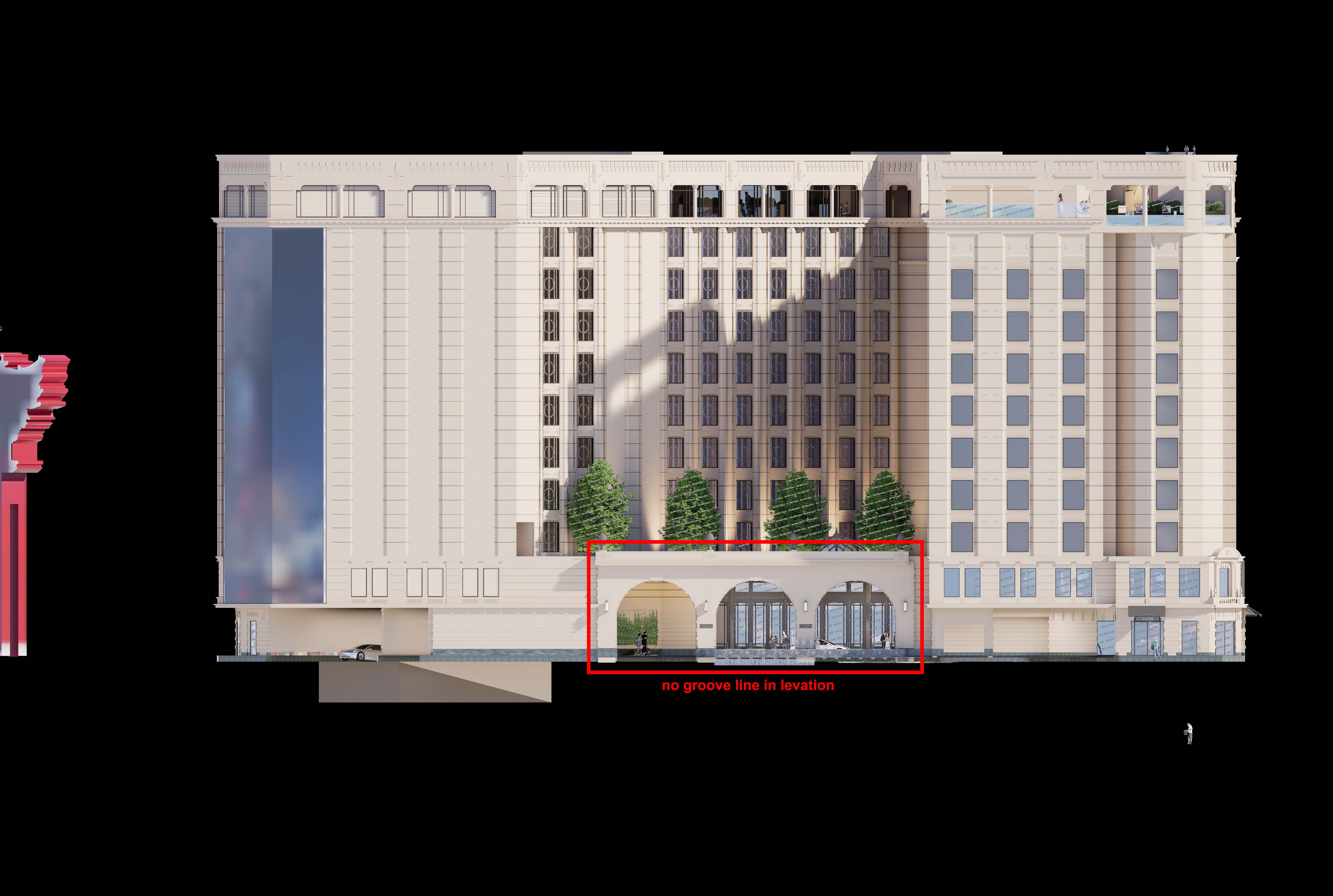

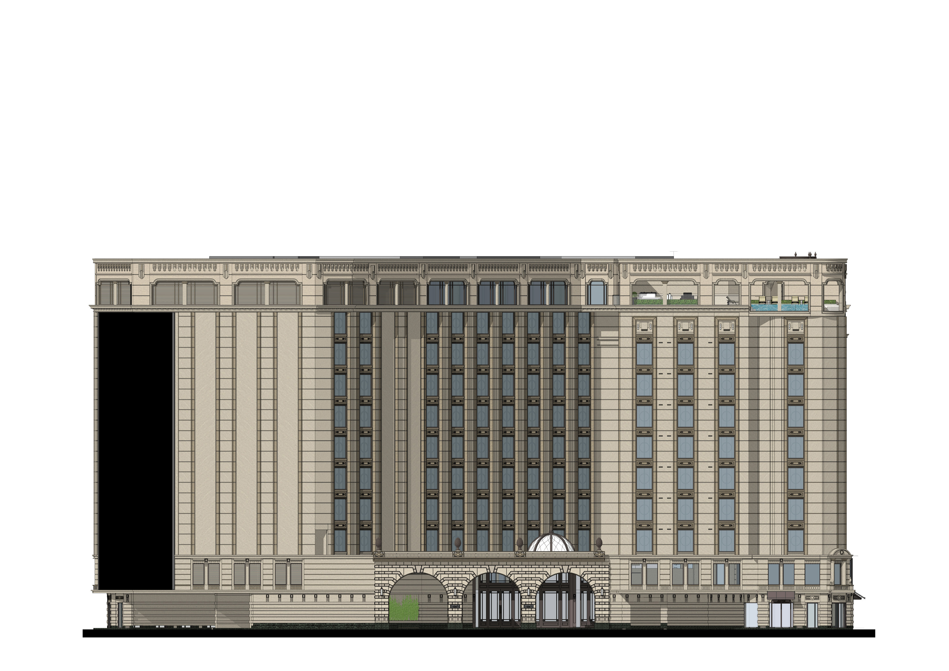

My model have a lot detail ( Groove line). But after rendering Elevation view. can’t see groove line.
Perspective view can see groove line.

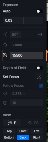

Can you send us a screenshot? Additionally, try modifying the Camer Clipping Plane to a value of 15500 and see if the visual compromise is still evident.
This is sketchup and after rendering. Some detail is lose.
The Groove line I use push/pull tool deep about 3 cm. It small?
and I turn on Outline mode before rendering.
I will try thx bro.
