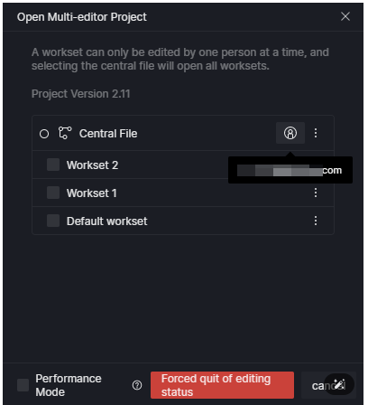

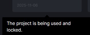

I was working on a TEAM project. my computer crashed, and the D5 project is locked and greyed out.
How to open it?

Hi @ye.li
Please contact your team administrator to enable “Forced quit of editing status” for the project.
