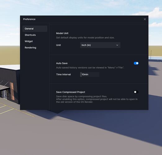

My local library is missing. I checked Preferences and Asset location, and the option does not appear in the popup. Is this new? Where do I look to set the library location?
Hi @robertpolkarchitect
If you’re looking for the workspace path or local library location, starting from version 2.11 this setting has been migrated to the D5 Launcher, so it no longer appears inside the Preferences popup.
