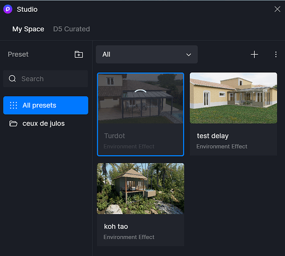

I saved an environment preset in 5 seconds, if I want to load it into my scene, it continues to loop and nothing happens. Thank you for your help.

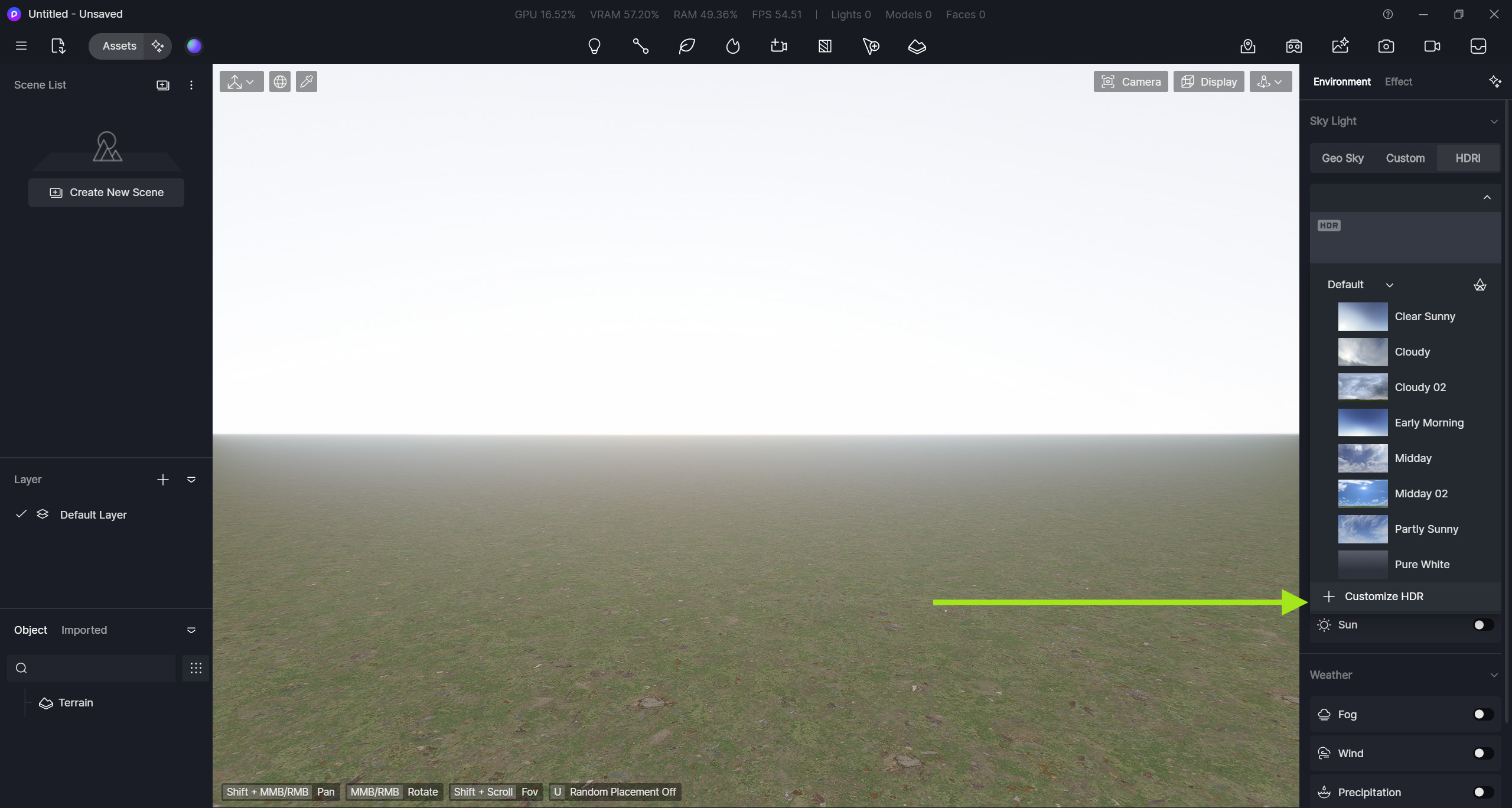

Can you check if this custom HDRI is present in your Workspace folder? It is usually found in this file directory C:\D5 WorkSpace\customhdr

Yesterday I recorded a new environment, which I saved and was able to save and reuse.
Today, I tried to save the “Turdot” environment, but I still can’t reload it.

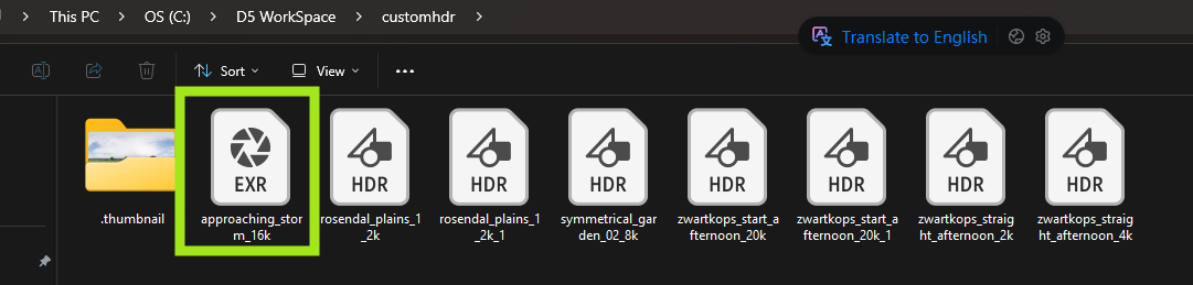

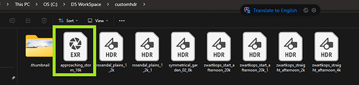

I just tested your file. Please make sure that the HDRI that you have used exists in the D5 Workspace folder > Custom HDRI. If this specific HDRI does not exist, the problem occurs, and it will load indefinitely.

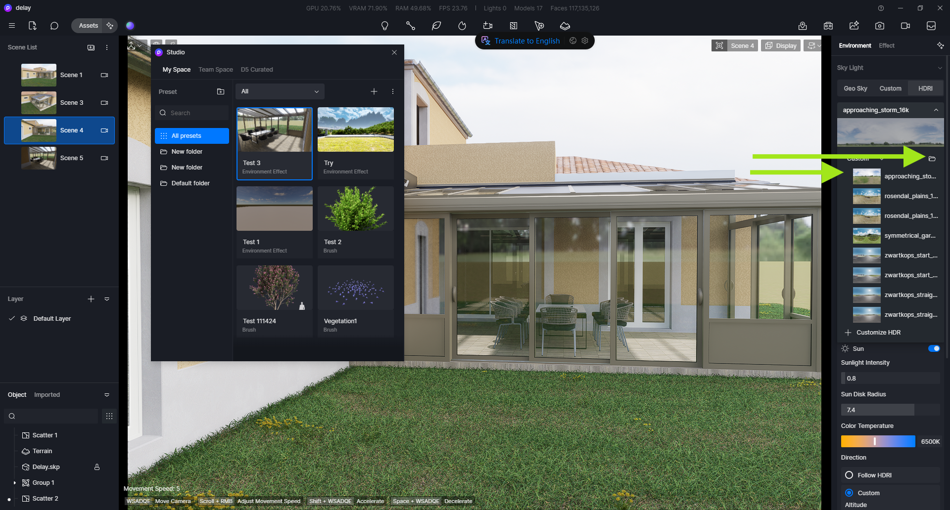

I downloaded the exact same copy of your HDRI from polyhaven and imported it to D5 then generated the Preset again, now it is working normally. Approaching Storm HDRI • Poly Haven

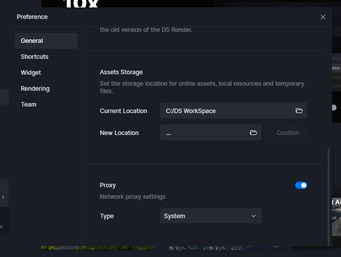

- Usually it is in this path C:\D5 WorkSpace\customhdr
- You can also check it in D5

Once you have imported a custom HDRI it should appear in the workspace folder. Otherwise, you may have deleted this HDRI unknowingly or perhaps reinstalled the Workspace folder.

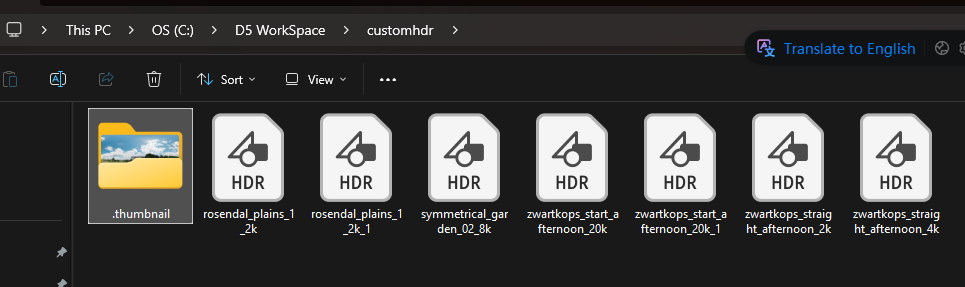

I did another test on the laptop: I downloaded an hdri, in a new project folder. In D5 I created a new environment preset. If I reopen D5 and apply the new preset it works. but the hdri file does not appear in the Windows/D5 Workspace folder
Then I tried on the desktop PC and it works too except that I don’t have a Windows/D5 Workspace folder on this computer…
- After importing the custom HDRI to D5 Render, it should appear in the workspace folder. Try to access it in this manner and see if the custom HDRI is present, please send us a screenshot too. It might be possible that you have multiple WorkSpace Folder installed.
