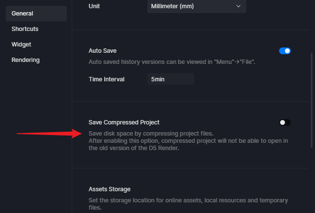

  • Enable this option, but you will not be able to open the file on lower versions of D5 Render
    Snipaste_2025-07-02_06-04-21

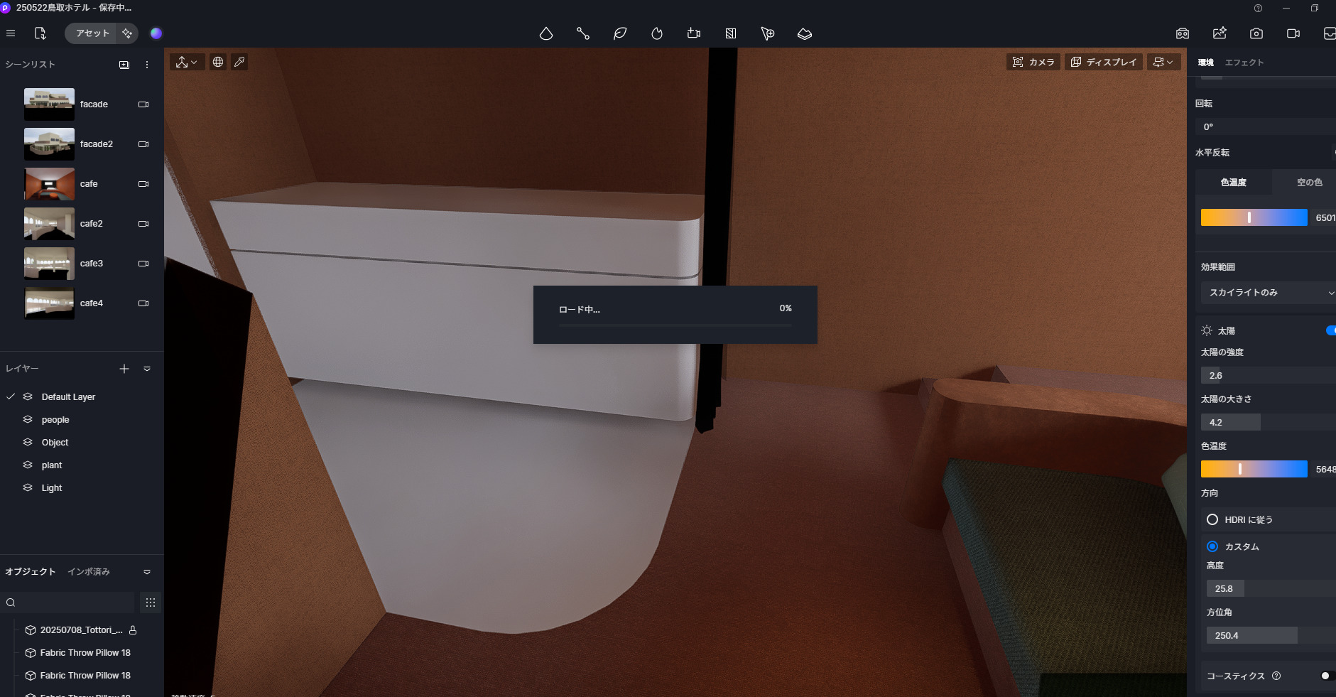

For example, when syncing from rhino, even in the early models under consideration, it freezes for about 10 minutes with 0% loading. I have the impression that it was not this heavy before, but it is getting heavier and heavier.
