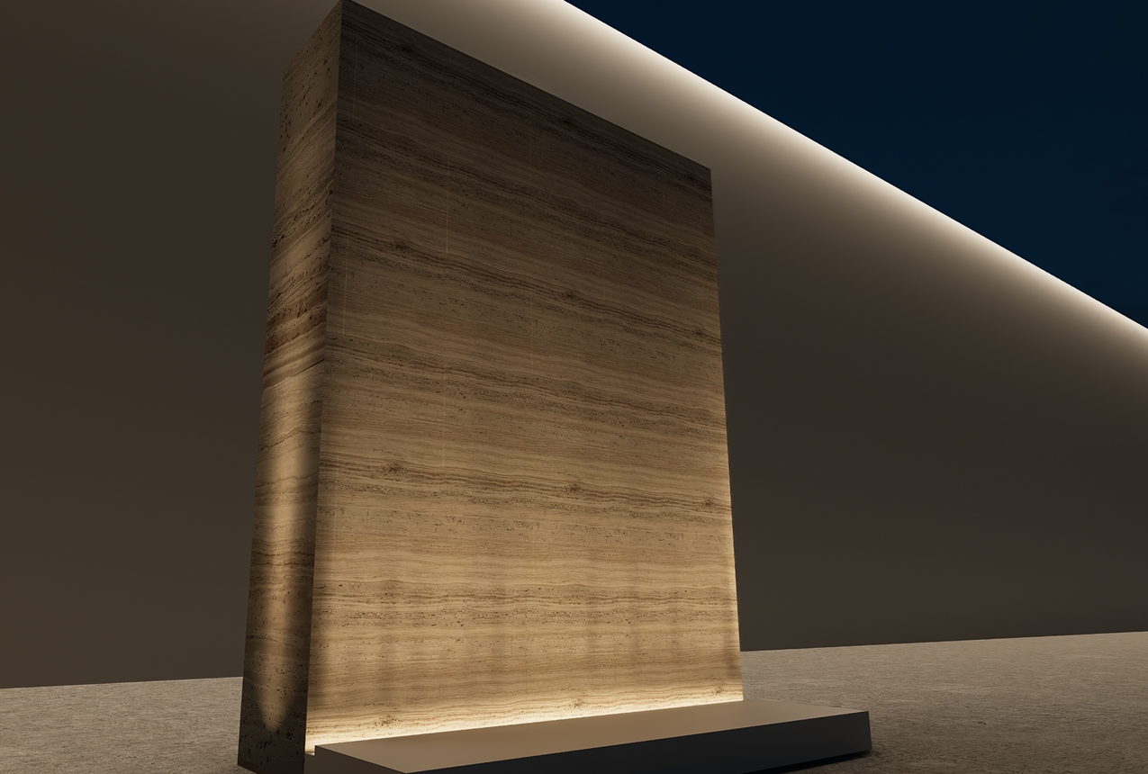

The first part of the video looks great, as shown in the following image:

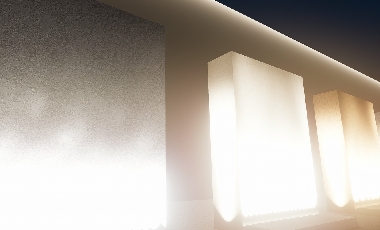

However, the subsequent shots show an annoying glare, as seen in the image below:
Note: Before updating the software, I had exported a video of the same project without this issue appearing.

what GPU do you use?
Hi @zayod.151
I tested your file, and there are no issues on my end using the exact same setup that was in the file you sent.
Was there something I missed with the process you have done? Can you perhaps record a screen-video of the whole process on your end? Thank you.

I completely uninstalled the program and the NVIDIA driver, then reinstalled both — and the issue was resolved
Thank you for your support
