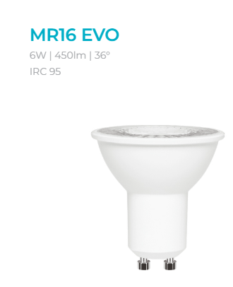

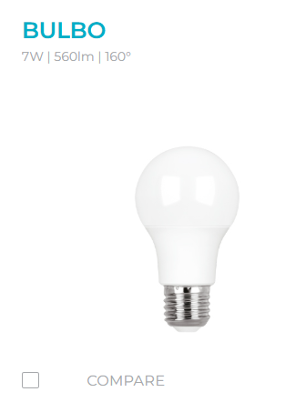

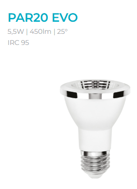

It seems that the intensity slider is caped at a 300 lumen max but most comercial residential lights are above this value. I understand I can type the value but, it is not ideal to make fine adjustments after that because the slider becomes unusable.
Here are some examples:
It seems to me that it would make more sense to have the slider within the common lumen range for real lights since it is using real world units.
