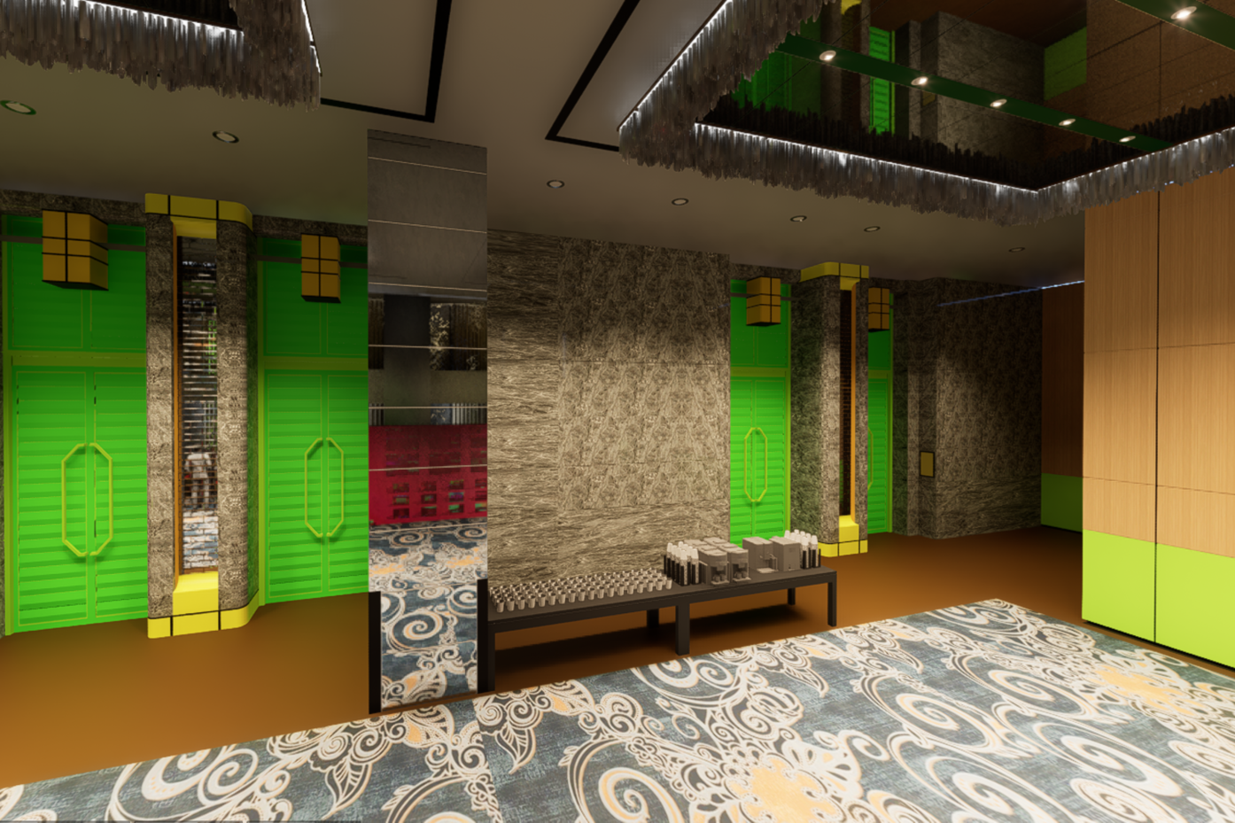

The light icon is not displayed, so it is impossible to move, and all the existing material values have disappeared, so I have to put it back on, is this an error? Or did I press the wrong button and this happened?

Yes, I previously put the material value in the D5 rendering, but after synchronizing the sketchup D5 Live, it suddenly reset to its original value

We did not rename or change the Sketchup material.
I don’t know about cloud storage. The material used in the previous asset has also changed to the previous material
There was no replacement window.
Sketchup version is 23 version and d5 plug-in recently updated. I changed the ceiling structure and updated it, but the material came loose
