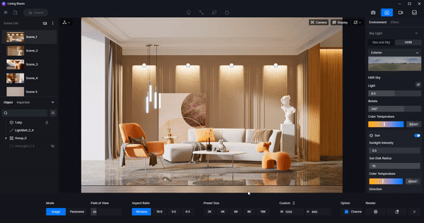

Hello, if you want to export those channels, try this:
ezgif-7-8ec111cd3c
I think their main use is in post-production. And you can export them along with your renders, the put them into PS or other software.
