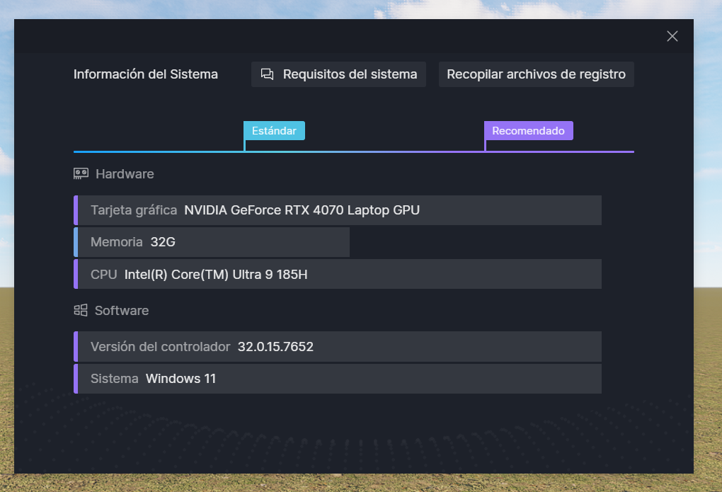

- System Information

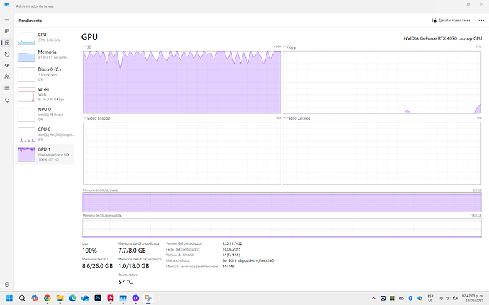

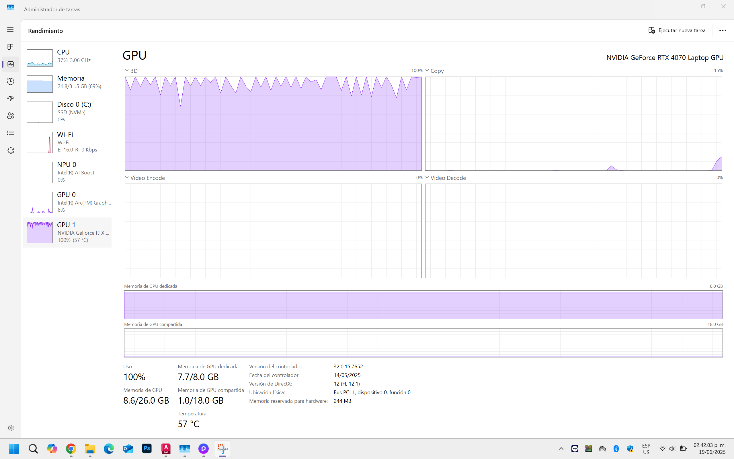

- VRAM - Please open your file while accessing this portion of the Task Manager

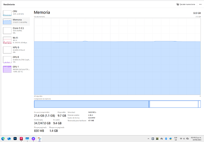

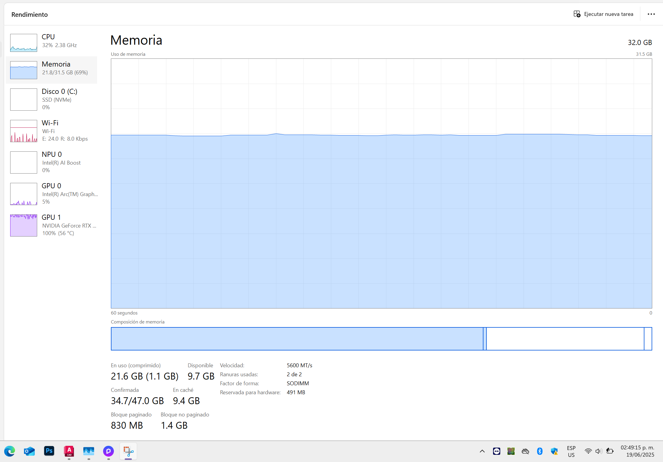

- Memory Speed
share with you the requested information.
SYSTEM INFORMATION
VRAM
MEMORY SPEED

Thanks for sending these images. I would like to point out a few things on this.

How simple and heavy is this particular file? Based on your VRAM screenshot, it’s almost maxed out at 7.7 GB / 8.00 GB (lag is expected) at 100% Utilization.
I would also like to point out that your Memory Speed is at 5600 MT/s, we do recommend setting it around 4000 MT/s to avoid crashing.
