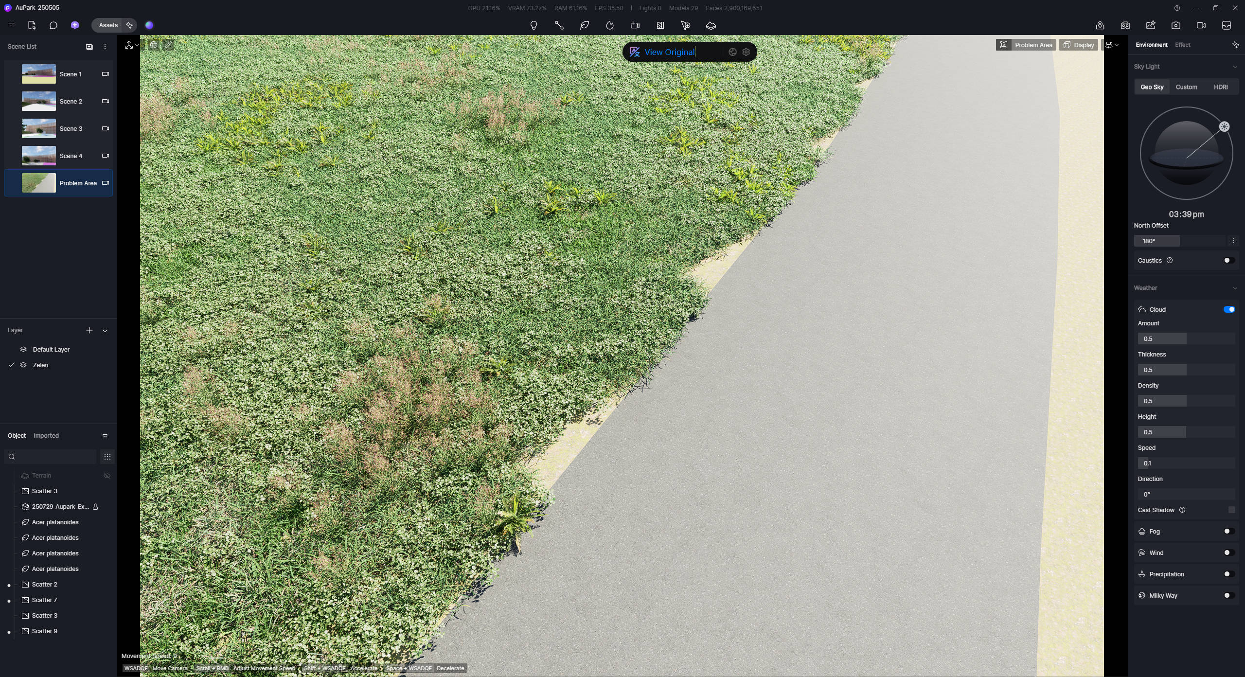

I’m having issues with the scanner.
There are uncovered areas remaining, and it’s unclear what’s causing this.
Before the last update, everything worked fine

After the update, this issue occurs in every scene.

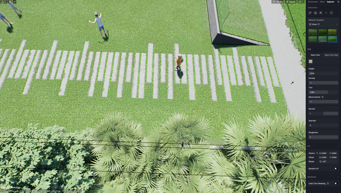

Here is image with only scatter applied for grass. You can see stepping stones some areas dont get filled with grass. Even after a new slider being introduced as scatter quality. Which on default is at 70. Even after maxing it out to 500. doesn’t help with result. Still get lack of the scatter in certain area.

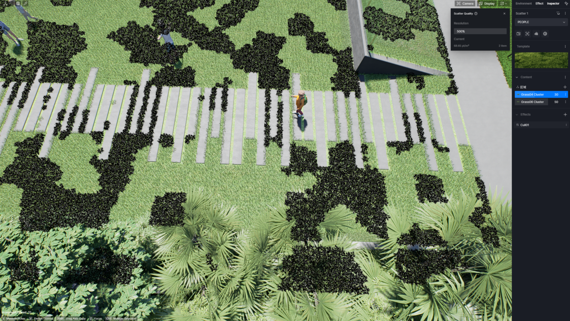

Here is the same after applying both scatter for larger grass and also applying material as grass for some areas that doesnt reflect grass patches. Empty zones get filled. but reduce the height and also trim it so it doesn’t over shadow the existing scatter used.
I know its not the solution to the problem u are facing because even am getting the same error you are at certain edges. As you can see at the extreme right edge of every image its that same issue. the scatter has come above my paving while its not supposed to even after applying the culling in the material. Also yes. This was not happening in 2.10 used to happen in previous version before 2.10 and now back in 2.11.

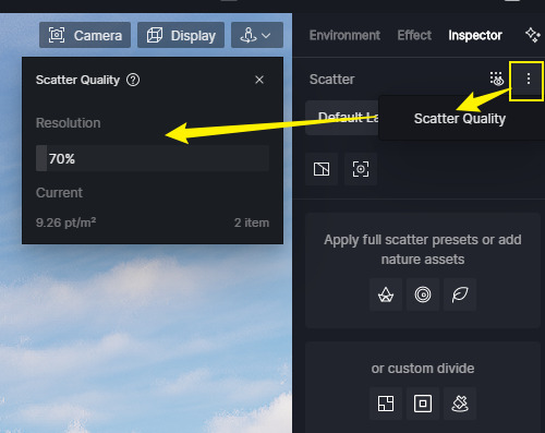

We have confirmed that this is a known issue before, and that the edges were not scattered. Now, it can be optimized by adjusting the resolution of the scattering precision.
