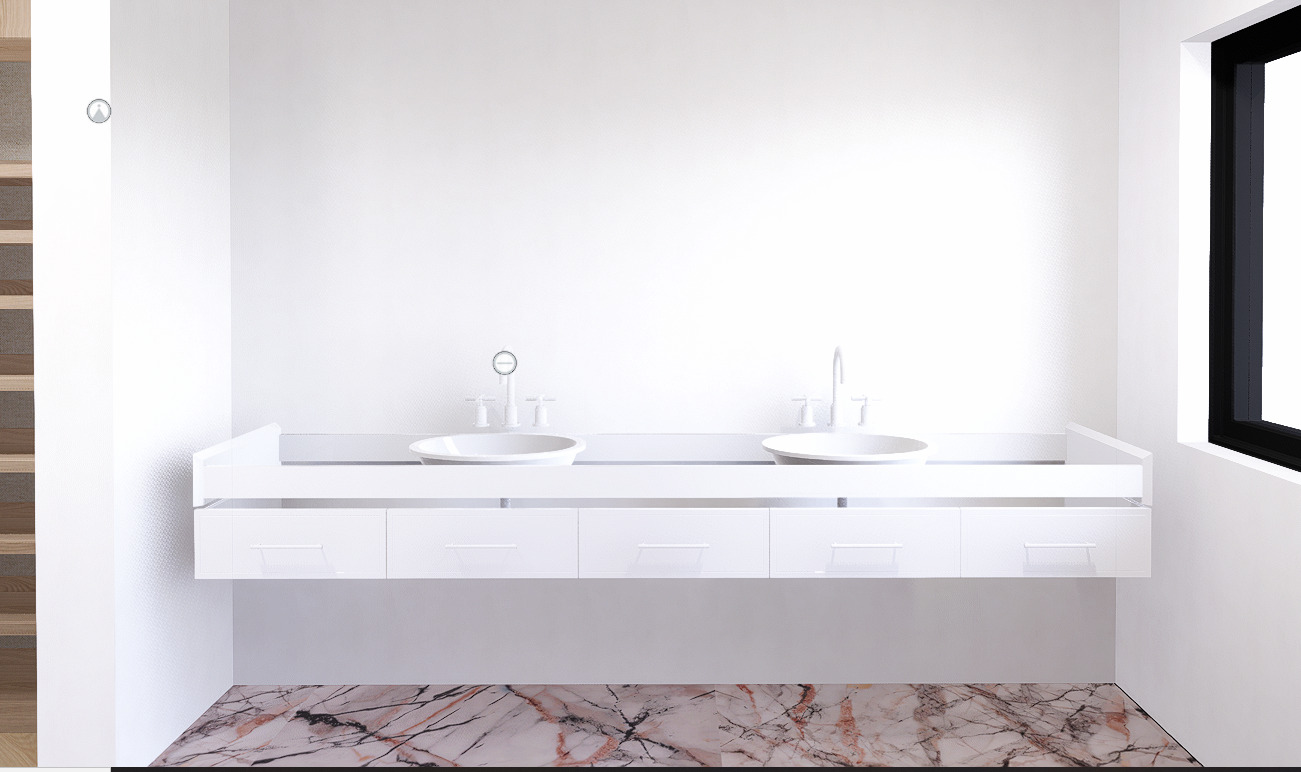

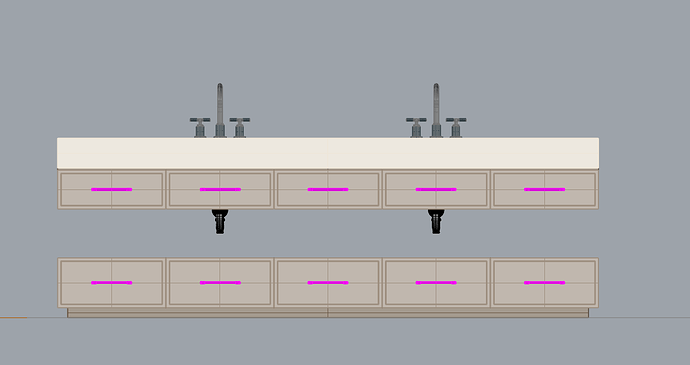

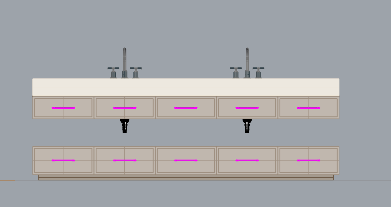

I’m been working many days with a D5 project by importing different Rhinoceros 7 .3dm files, but when I make changes and import again the same something happen in D5 that dissapear some surfaces, I tried changing materials and layers (names) but it still not working. I spend lots of time on this until I achived imported correctly the file.
I attached some screenshots of this problem.
Original file
original file imported in D5
Any idea?
Thanks!!

Hi alfredo, we opened your file and found that the problem is due to kind of incompatibility of the file with D5, we will look into it.
For now, you can explode that part directly, and it will be imported into D5 with no problem.
Also, you can use the D5 Converter for Rhino to import the model.
