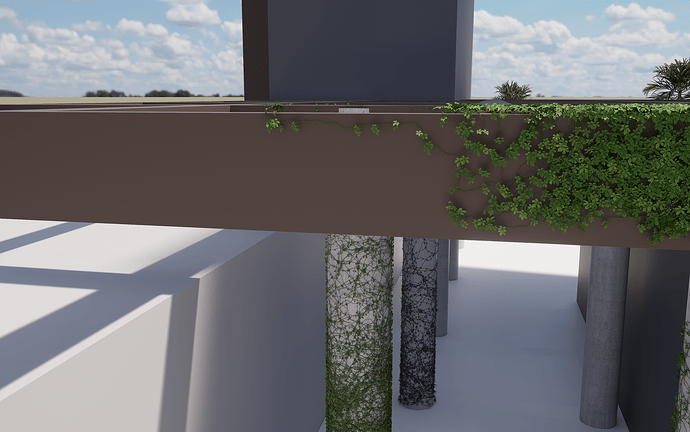

I’m having a problem with branches and leaves in Procedurally Vine. Both in the Viewport window and in the final render. Some are appearing completely gray, as shown in the first image below.

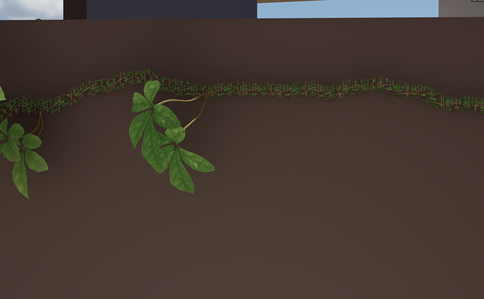

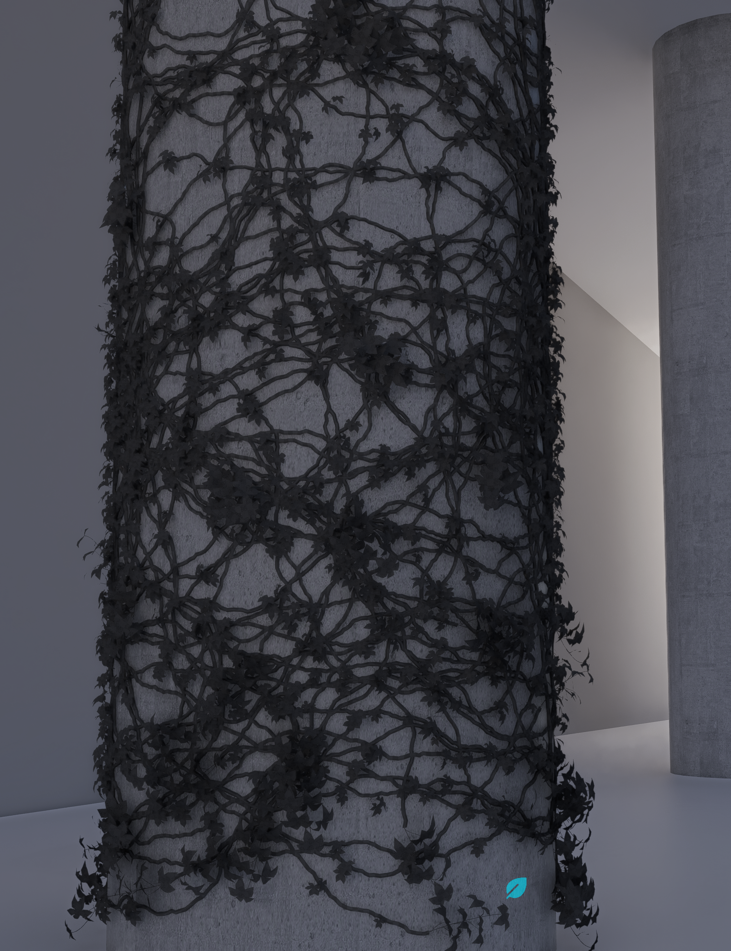

Others have some anomaly in the texture of the branches, a texture mixed with leaves and wood with transparency, as shown in the second and third images below.

  • The issue regarding the vines is a known bug, but it was only evident in the Bougainvillea variant. Can you specify which assets were used on your end?
  • As for the abnormal gray appearance, it seems like it is similar to the problems that the 576.02 Driver Version with RTX 5000 Series GPU has brought. Please try to revert to the previous version and see if this gray appearance disappears.
If the gray appearance of these vines is still evident despite reverting to the previous version of your driver, we may need to collect it. Please send us your D5 File Folder and Log File

The problem with the texture on the branches only occurs with Vine Chestnut. The problem with it turning gray only occurs with Virginia Creepe, and I reverted the driver to the previous version and the problem of it turning gray remains.
