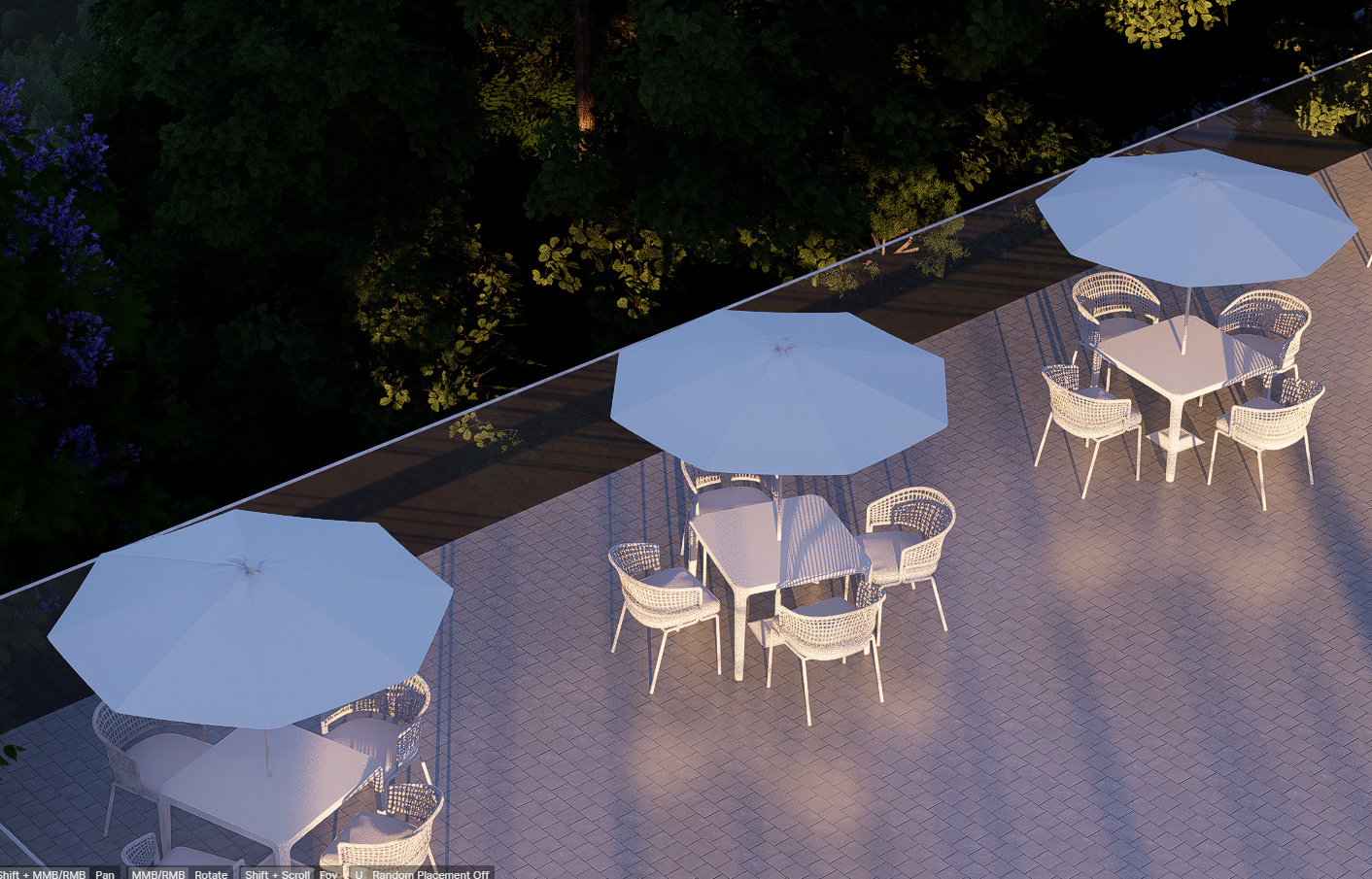

Hello D5 Support Team,
I am experiencing an issue when using the Custom Path function in D5 Render (Version 1.0.0.0205).
  • The furniture assets I placed turn into white models.
  • They cannot be hidden or deleted once this happens.
Steps to reproduce:
  1. Place furniture assets in the scene.
  2. Enable and apply Custom Path.
  3. The furniture assets automatically change to white models.
  4. Attempts to hide or delete them do not work.
Environment:
  • D5 Render Version: 1.0.0.0205
  • GPU: NVIDIA RTX 4070 SUPER
  • OS: win11
Could you please check if this is a bug or if there is a workaround?
Thank you for your support.

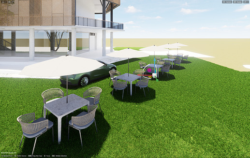

Hi @wjdwlgus3000
I apologize for the late reply. Are these models from D5’s online library or from your local library?
  • Can you share with us which asset was used, if it’s from the online library? And if it’s from your local, then please share.
just online library.
Then, which specific asset?
  • I tried looking for a similar asset based on your screenshot. Is this the Outdoor Dining Set 07? Materials are showing correctly on my end, and this was made using the Custom Path Tool.
  • Can you confirm if other assets display similarly on your end?
  • Please also check your X,Y, and Z values of the model. If it’s too far from the origin, try moving them closer to 0,0 and see if the issue persists.
