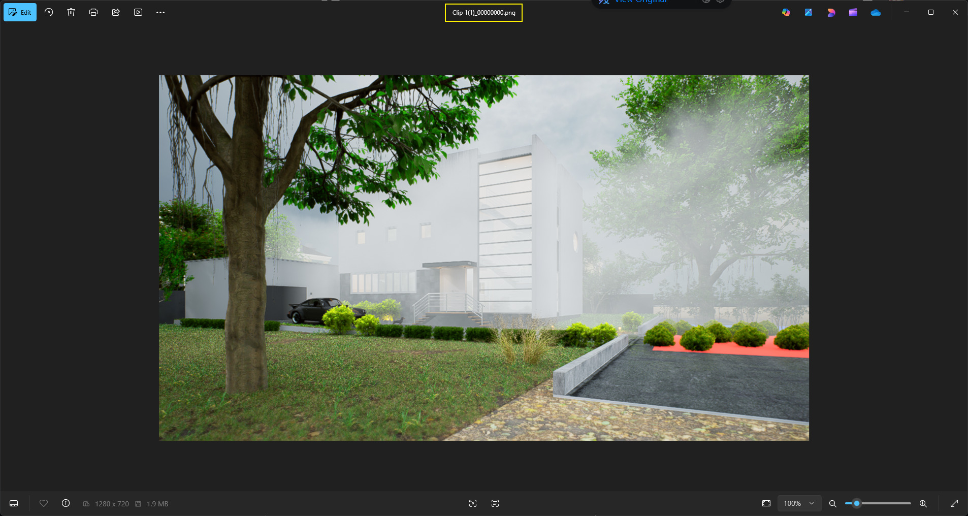

D5, latest version, has an issue on animations when the fog is on. I haven’t tweaked the fog for each shot (camera). I have set it only one time.
As you can see in these two frames, the first one has incorrect fog. It happens only on the first frame of each sequence. I must delete the first frame.

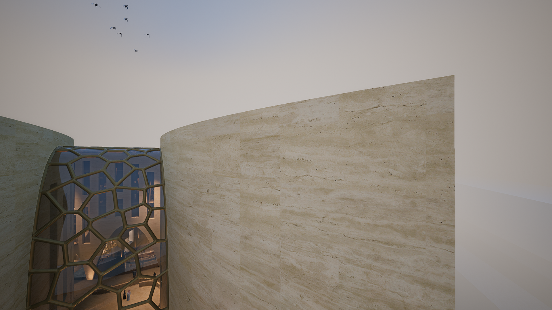

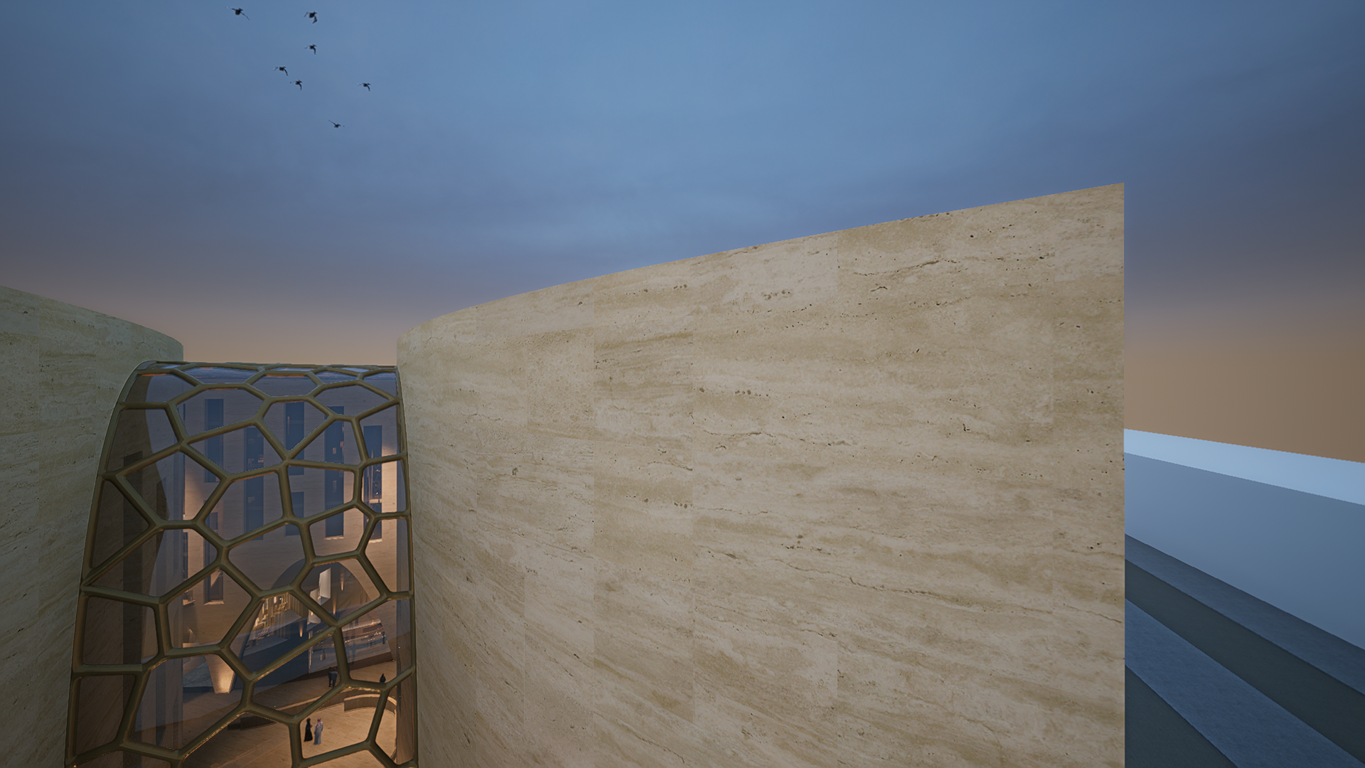

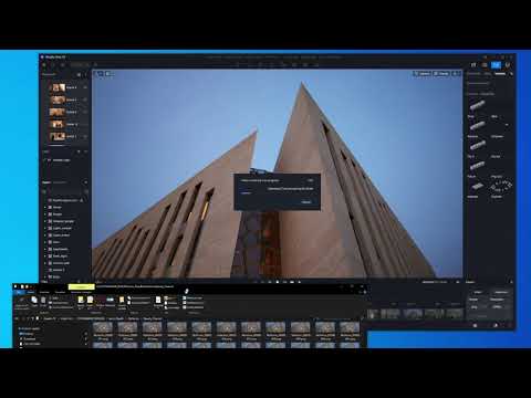

Because I’ve shared my scene, you can also see the fog bug that occurs when saving a PNG sequence.
Please check my video to see exactly what happens.
At the moment, each sequence contains two frames with incorrect fog rendering.
I hope that with my scene you’ll be able to reproduce and fix the issue.
