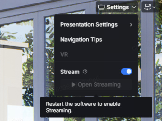

The Interactive Presentation can currently be shared in two ways:
  • Present it directly from the local machine.
  • Use Pixel Streaming, which streams the Interactive Presentation to a web browser in real time, allowing others to view and interact with it without installing D5 Render.
However, please note that Pixel Streaming currently supports local area networks (LAN) only. This means both the host device running D5 Render and the receiving device must be connected to the same local network for the streaming session to work. This is a current limitation.
