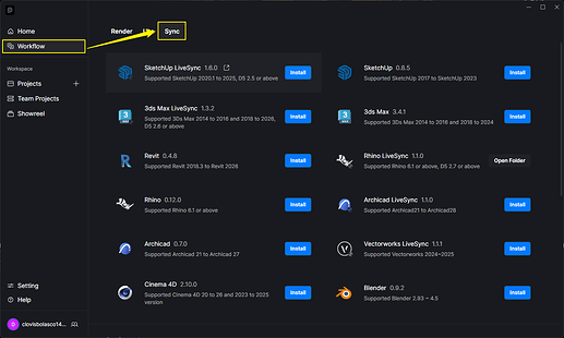

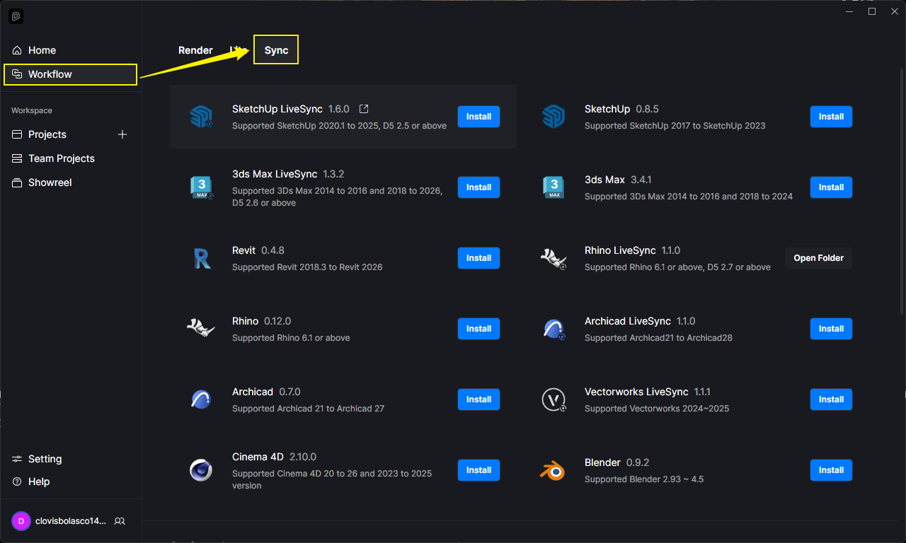

I just can’t see the D5 icon/Plugin in my sketchup toolbar, but I can see the Icon in my desktop.
Hi @Mooh
Installing D5 Render does not equate to installing the plug-in  , you need to download or install these plug-ins separately.
If you have installed the plug-in but still can’t see it in SKP:
- Please ensure that you have selected the appropriate SKP Version upon installing the plugin.
