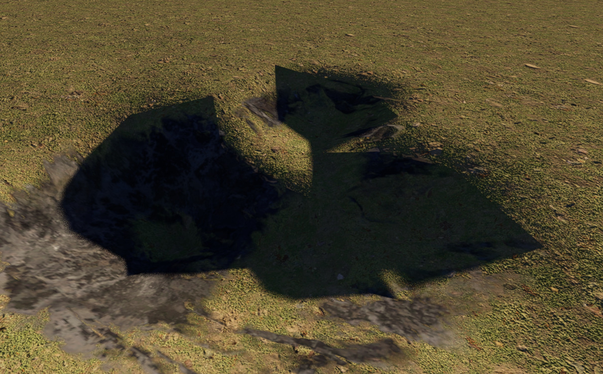

Hi, is there way to increase terrain resolution ? I mean that shadows on terrain have very low resolution :

This is done by simple brush on default scene and terrain

This is within expectation when working with a small brush size. That said, I’ll be sure to share your feedback with the team for review. Thank you.

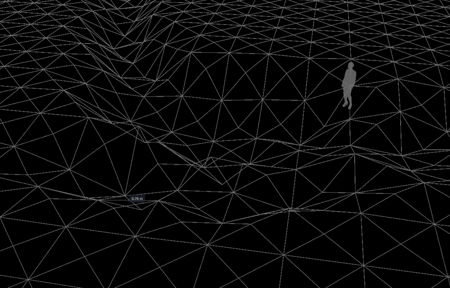

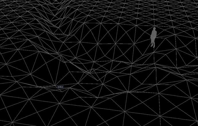

Terrain 3d resolution is way to low. This is why it produce that low quality Sun shadows
There should be option to increase terrain resolution, tessellation - the best based on camera distance.
Currently there is no way to work with it on small distances.
