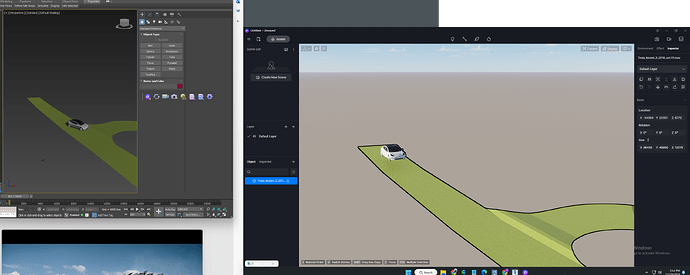

hi guys, i have project to make a animation car entrance the building, i already done making the animation in 3dsmax, but i cnt import it to D5 anyone can halp, im traying to import with fbx and alambic format but still cnt, here the link download for 3dsmax file, thnks sorry my english not realy good

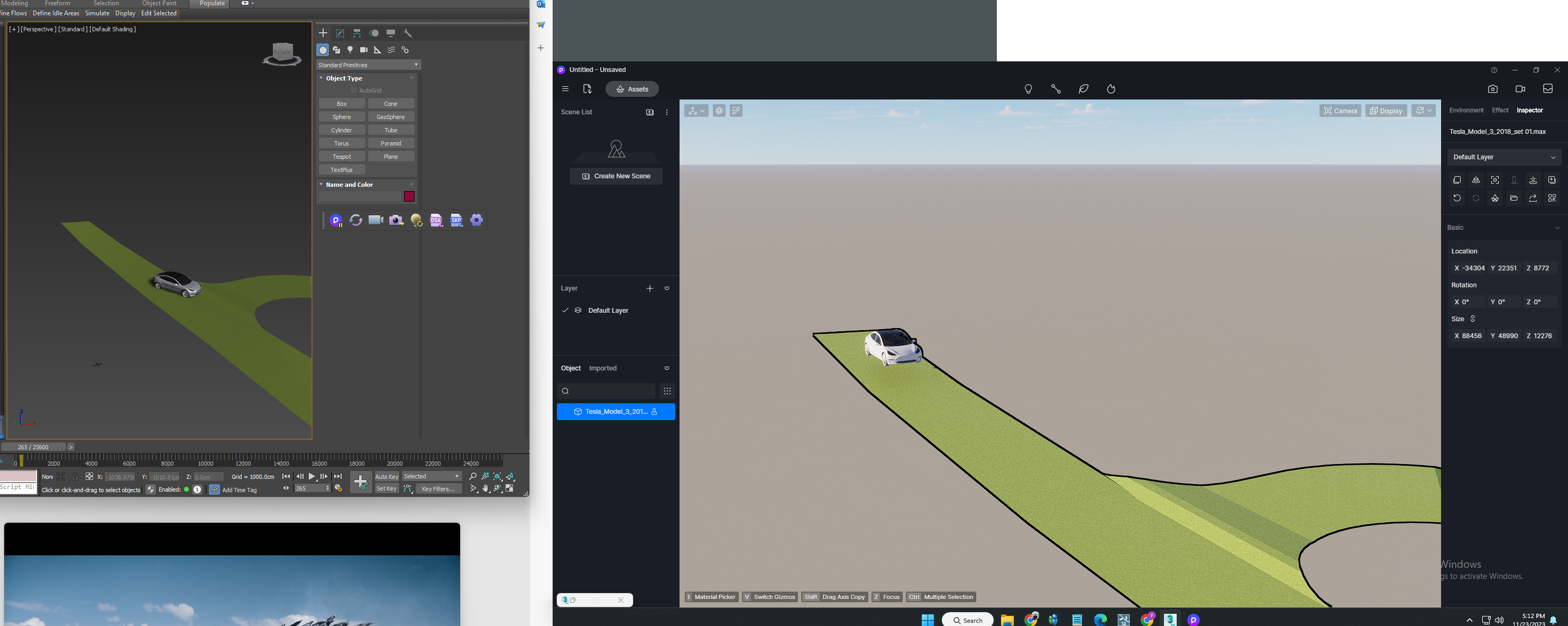

hi luna, already import it with that plugin, but the animation its not working
Hello! Currently D5 doesn’t support fbx with skeleton animation, please convert to abc. format for import. Also, please note that abc.format animation does not support material import.
