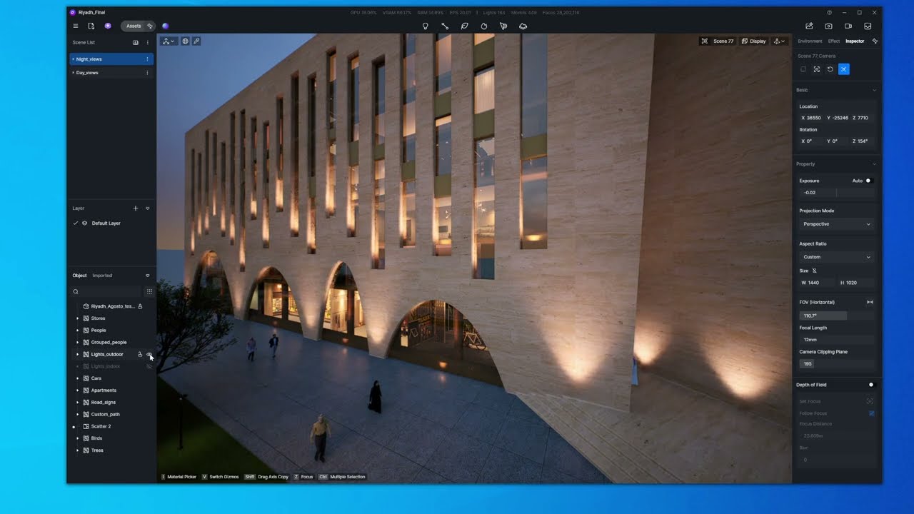

I have encountered a bug concerning the IES files assigned to lights.
Please refer to this video I uploaded on my YouTube channel for a clear demonstration:
In my project, I created several groups of lights, each with its own IES file. Unfortunately, when I activate (make visible) two groups at the same time, the first group incorrectly adopts the IES files from the second group, even though its own IES files are correctly loaded.
This issue prevents me from proceeding with my work. I kindly ask you to fix this bug so that each group of lights properly displays its assigned photometric file.
Let me know if you need my scene to catch the bug.
Best regards.

Hi Clov,
I watched your video, but you are only showing the geometric representation of the IES files, not the actual resulting lighting distribution.
In my video you can clearly see that the IES profiles are correctly assigned to each light group:
  • The wall washer lights (illuminating the basement wall) display the correct IES shape and, when they are the only active lights, they illuminate the wall properly with the right photometric distribution.
  • The IES lights for the interior bezel of the windows also show the correct IES shape and work properly when activated alone.
The issue occurs only when both groups are turned on at the same time.
  • If I first activate the window lights and then the wall washer lights, the wall lights incorrectly adopt the distribution of the window lights.
  • Conversely, if I first activate the wall washer lights and then the window lights, the window lights adopt the distribution of the wall lights.
In other words, the second group that is made visible always loses its own photometric distribution and inherits the distribution of the group activated first.
I’m gonna send you the entire project.
Best regards
