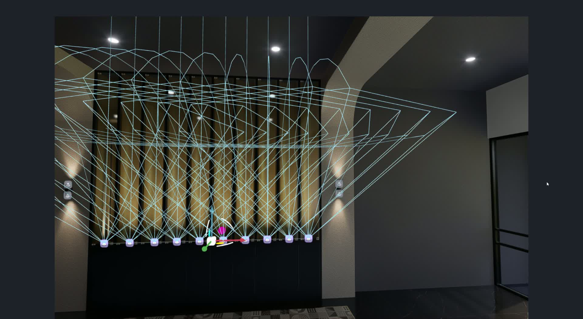

Let’s say i’ve set a group of ‘spotlight’ with an IES file name of 1.ies , then when i start to set a second group of light with other type of ies files e.g 2.ies , the first group of light that was set with 1.ies mixed up with the new 2.ies file… please help me
Hi @carter.toh98
May I know where you grouped these lights? Can you perhaps record a video of your process? Thank you.
here i try to upload a video… hope you can understand bcs i didn’t know why the D5 UI doesn’t appear in my windows screen recorder

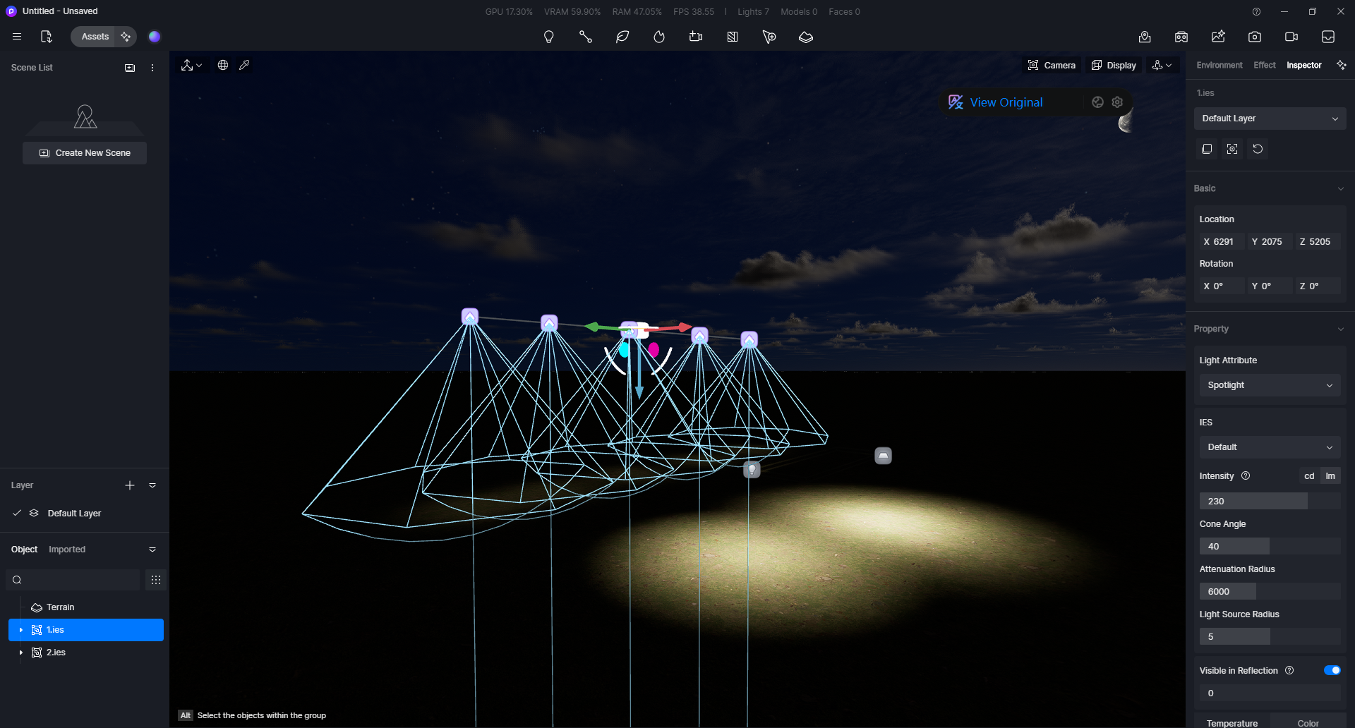

Indeed, its quite confusing knowing the UI is not showing. It might be caused by the screen recording software. I usually use NVIDIA by Alt+f9.
Anyway, based on I’m understanding on the video that you have provided and the description, I tried to replicate it on my end. And it’s working normally on my end.
  • You might want to check if the 1.ies group was opened or selected while adding the new lights, since if the group was selected while putting a new one then it will automatically belong to that group.
