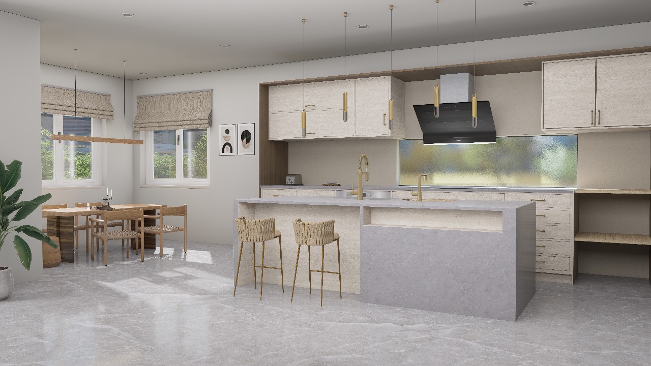

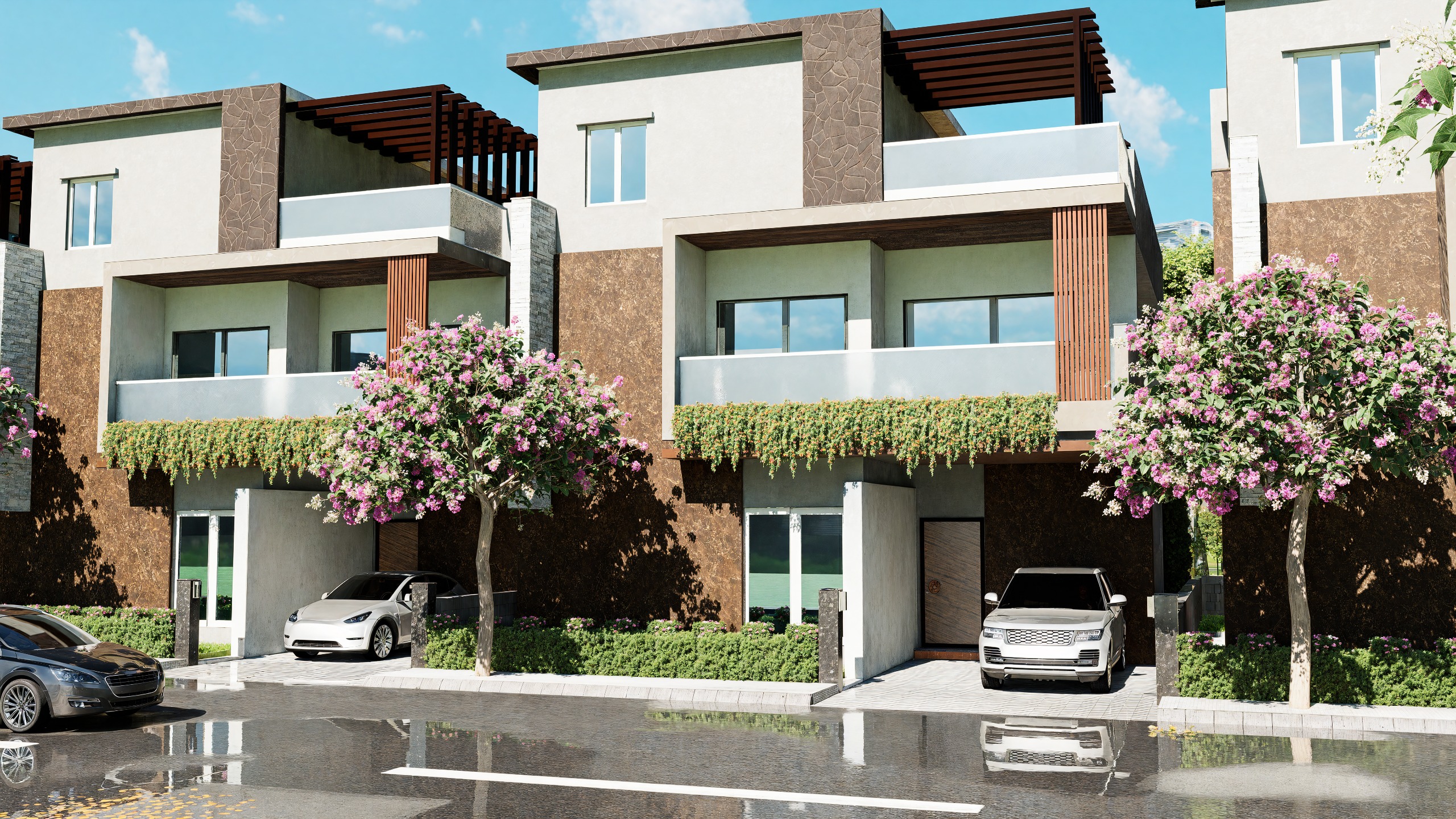

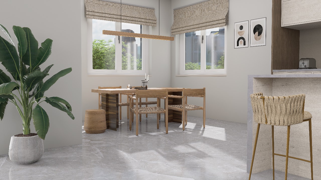

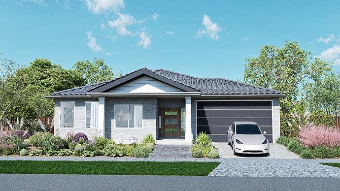

I want my render to look photorealistic, please help
I’ve been working with D5 Render from past 3 months for architectural and design visualization, and I’m trying to get a photorealistic render, but am missing something that I can’t figure it out .
Please help me to get photorealistic render.what am missing in settings please help.
I’m attaching some of my works down here.
Thank you

I think you can play with environmental settings or perhaps use HDRIs. If our current default HDRI does not satisfy the output you wish to achieve, you can download some and import it to D5.

I would comment your interiors… At a first glance they lack life. Just imagine what kinda
people are living thére and and more objects that would pass with their life style.
One should get the impression that those people left for 5 minutes and are about to come back. It does not increase automaticly the realism but it makes your image much more credible and interesting.
