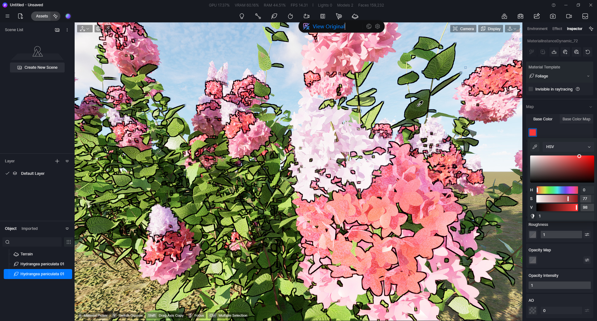

I need to change the color of the flower of a plant from the assets library.
I was wondering if there’s a way to change the flower color of existing plant models in the library. Specifically, I need Hydrangea paniculata with white flowers only, but the available versions in the software seem to have both white and pink, which doesn’t work for my design.

Hi @f.martin
For now, the method to change the colour of the flowers is to activate “Material Picker ( Press I)”, then select the surface of the flower you want to change then modify the Base Colour.

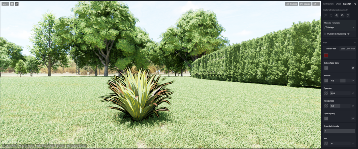

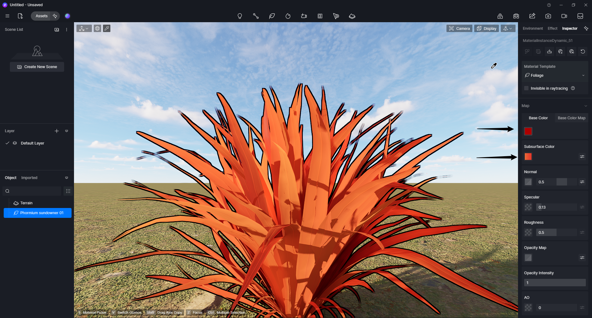

I’m trying to change the Base Color of a foliage model (a Phormium Sundowner) to make the leaves uniformly red. However, when I adjust the Base Color and the Base Color Map, the result is not satisfying: the lighter leaves still show the original model’s color. I only see the new color where the leaves are not directly lit.
How can I achieve a uniform color across all the leaves in D5 Render, regardless of lighting?
Should I adjust other parameters like the Subsurface Color, Opacity, or Specular settings?
Thank you very much for your help!
I’m also experiencing this issue. Several trees, such as Populus nigra, have a surface scatter color that doesn’t respond to any color adjustments we try to make. As a result, if I want to change the color, it only affects the lit side of the leaves — or something similar to that effect. In my case, I was trying to make the green of the leaves a bit warmer/more yellow, but it was impossible. I had to replace the trees with others that weren’t poplars.
Hi there,
Try inserting a solid colour PNG in Subsurface Colour.
