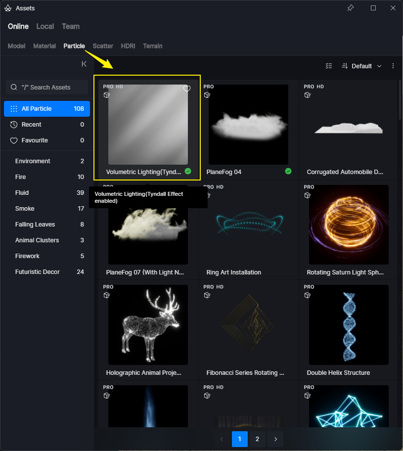

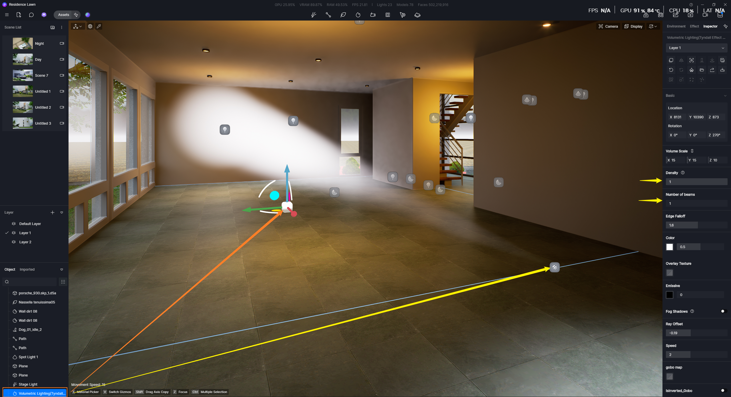

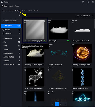

Try to insert a Volumetric Light Particle between the light and the surface where it is directed. Then change the Volumetric Particle’s parameter, reduce the number of beams, and increase the intensity. You may adjust other parameters, too, according to your preference.
Note: Fog needs to be enabled for volumetric light to appear.

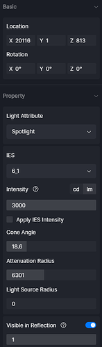

Yes, as you can see in my screenshot:
- These parameters are from the Volume Light Particle, but this particle is only available for the PRO version.

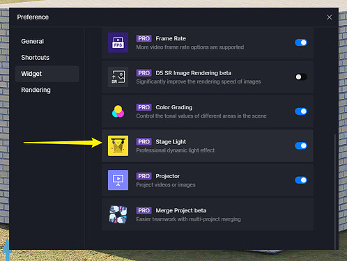

- I’m also using Stage Lights instead of spotlight assets, which is only available for PRO users
