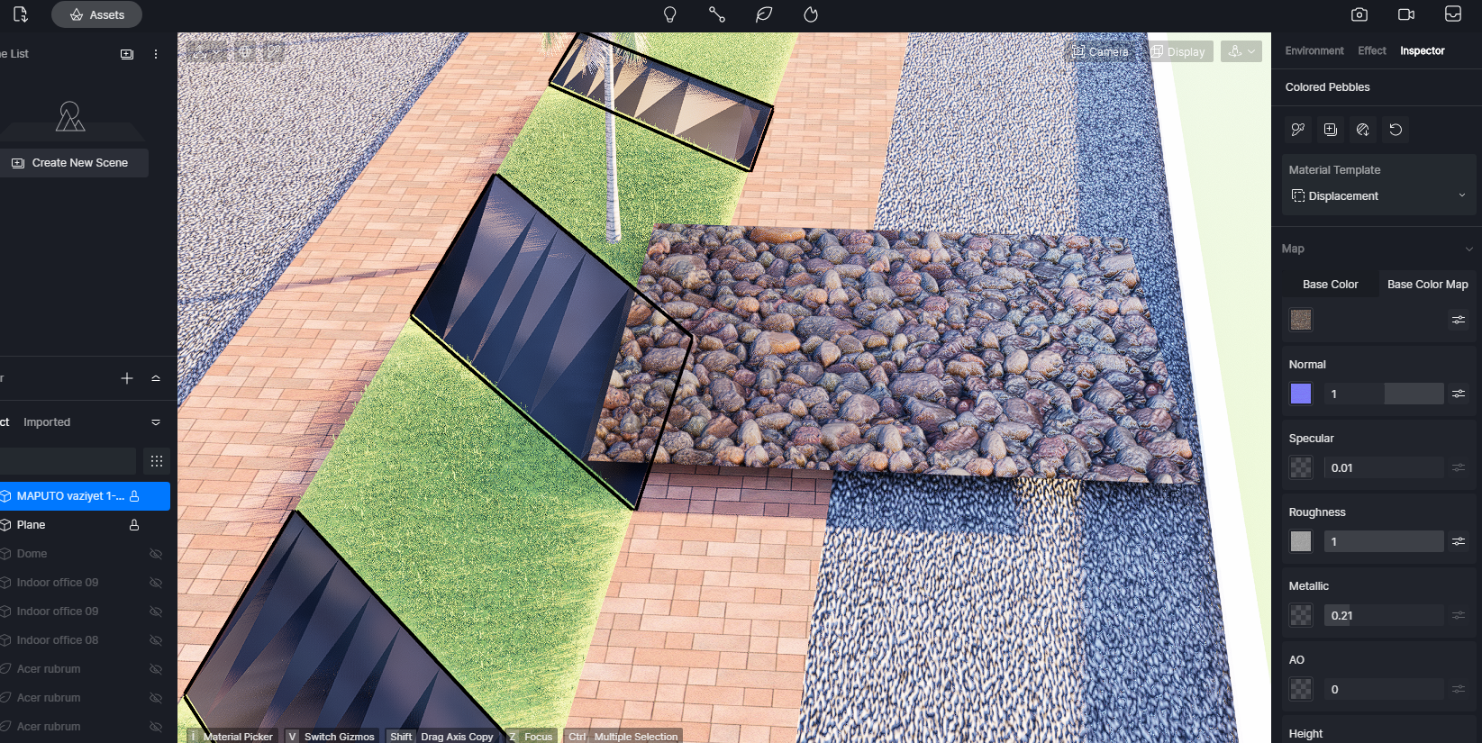

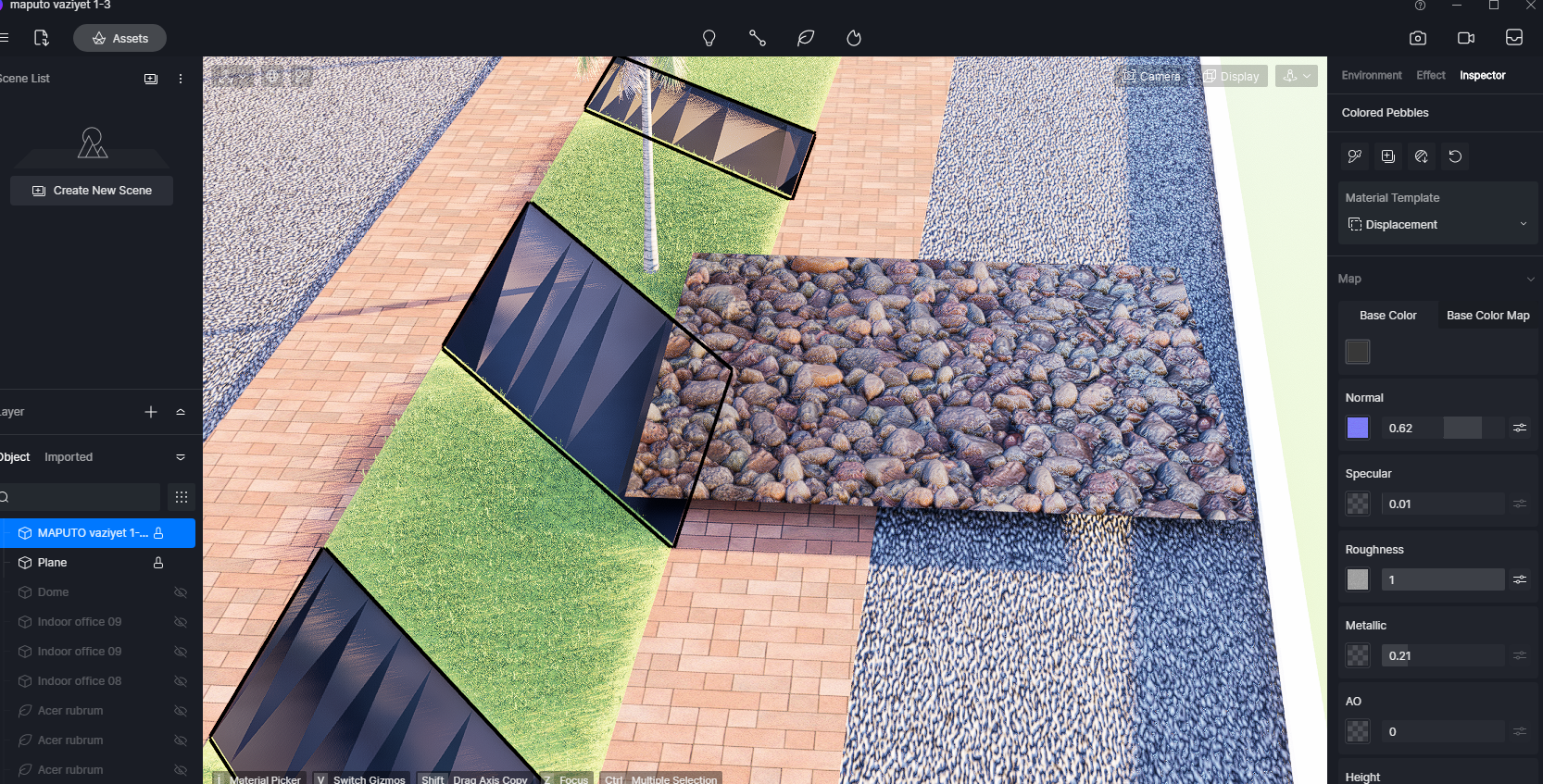

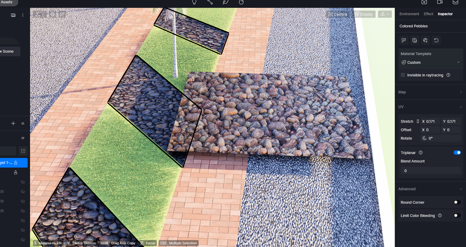

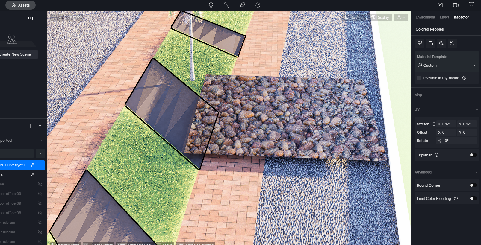

hi everyone, i have a problem.i can’t use asset material on my model.i cant use displacement. but it worked d5 plane or something. i can use only custom (triplanar on) material template but not good looking. tnks
Hello,maybe you can try assigning a UVW map to this slope in the modeling software, save and update the model, and try assigning a displacement map again in D5
At present, displacement maps perform well in the horizontal direction, but I have never attempted to use them on slopes
tnk u so much, it worked :))
