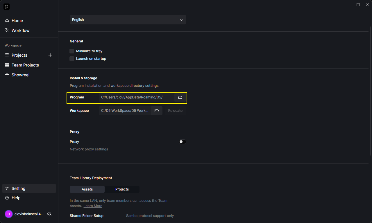

Hi @syjtdweee
Please follow these steps:
  1. Open your D5 Launcher and navigate to the software’s address.
  1. Copy or make a note of this address.
  2. When the prompt appears in SKP, select the copied address.
