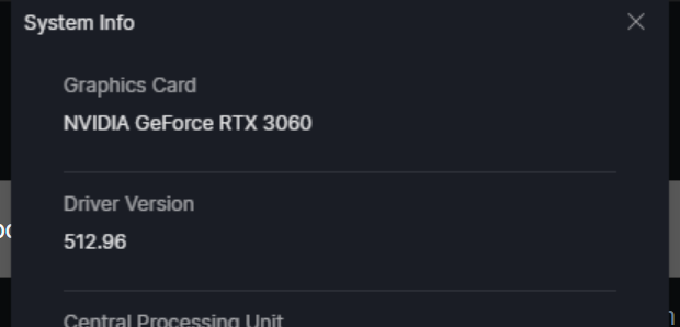

A:
- please update your video driver version if it is Nvidia 46x.xx.
