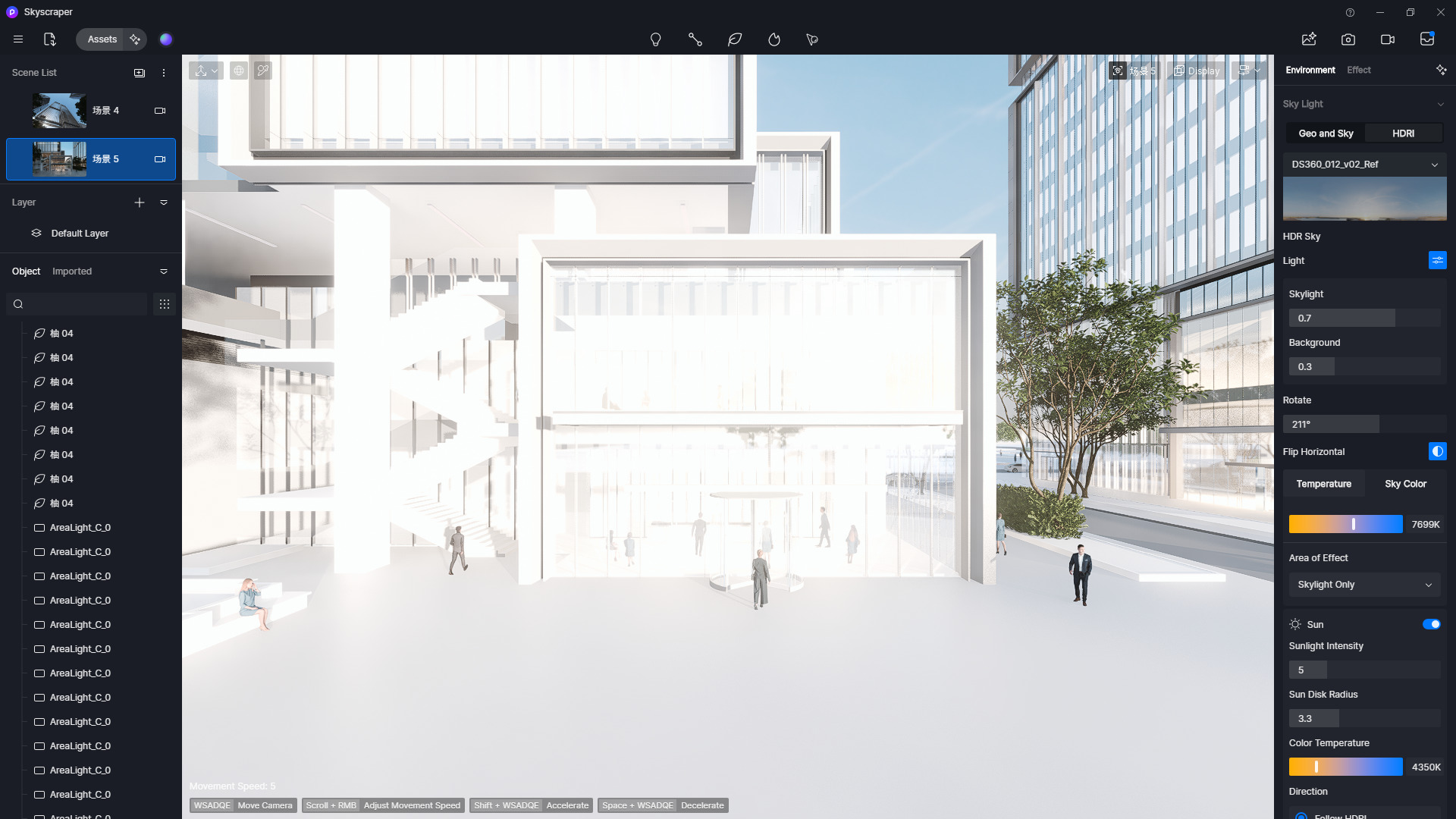

When I download the file from ‘Scene Express file’ and run the D5, there is a huge difference between the example image and the image I see. I wonder if this happens because I am a Rhino user, or if I missed something (this problem occurs in all Scene Express files).

My file image

The file in the image is Vol.70. The same thing happens in all files. There is a huge difference between the example image and the actual download image, and there is a difference in exposure, atmosphere, and even some assets or materials(There is no asset or the material is not applied).

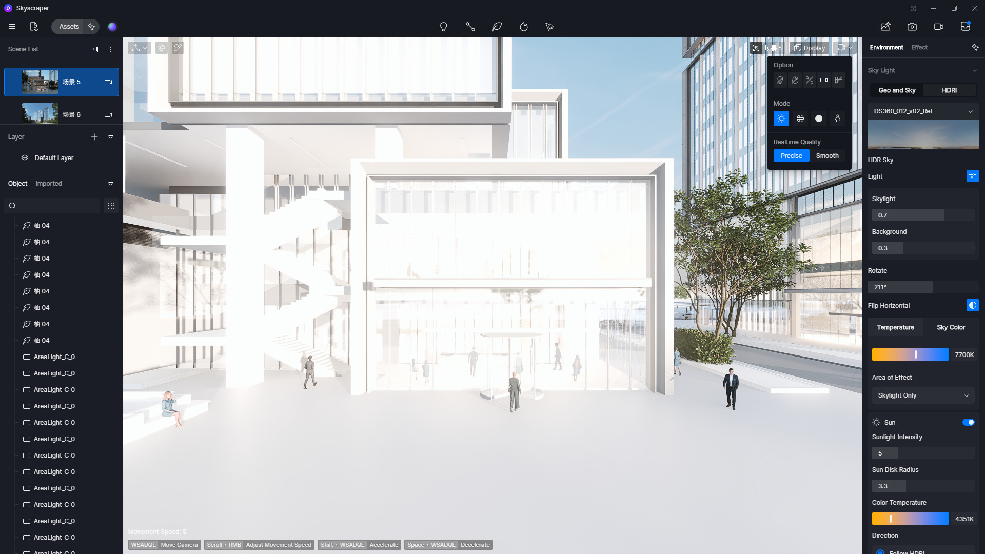

Hi cyh21534, maybe the problem is that you are in Smooth preview.
Try Precise.
Here some more info:
Hi there, I have tried it on my end, and we do have the same output, although it was on “precise” mode. This may be caused by the file being created in earlier versions of D5 and opening it with the current version (perhaps the gap is huge). Have you tried accessing files from Scene Express that are more recent?
Thank you for your kind reply. I checked with the latest file and got the same results. I guess I’ll have to give up learning from older version files. ![]()
I do suggest trying Scene Express files that are much more recent, around 200+ or even starting at 150+. I tried Vol. 280 Scene Express, and it works fine. ![]()
