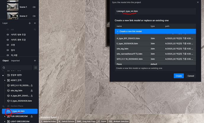

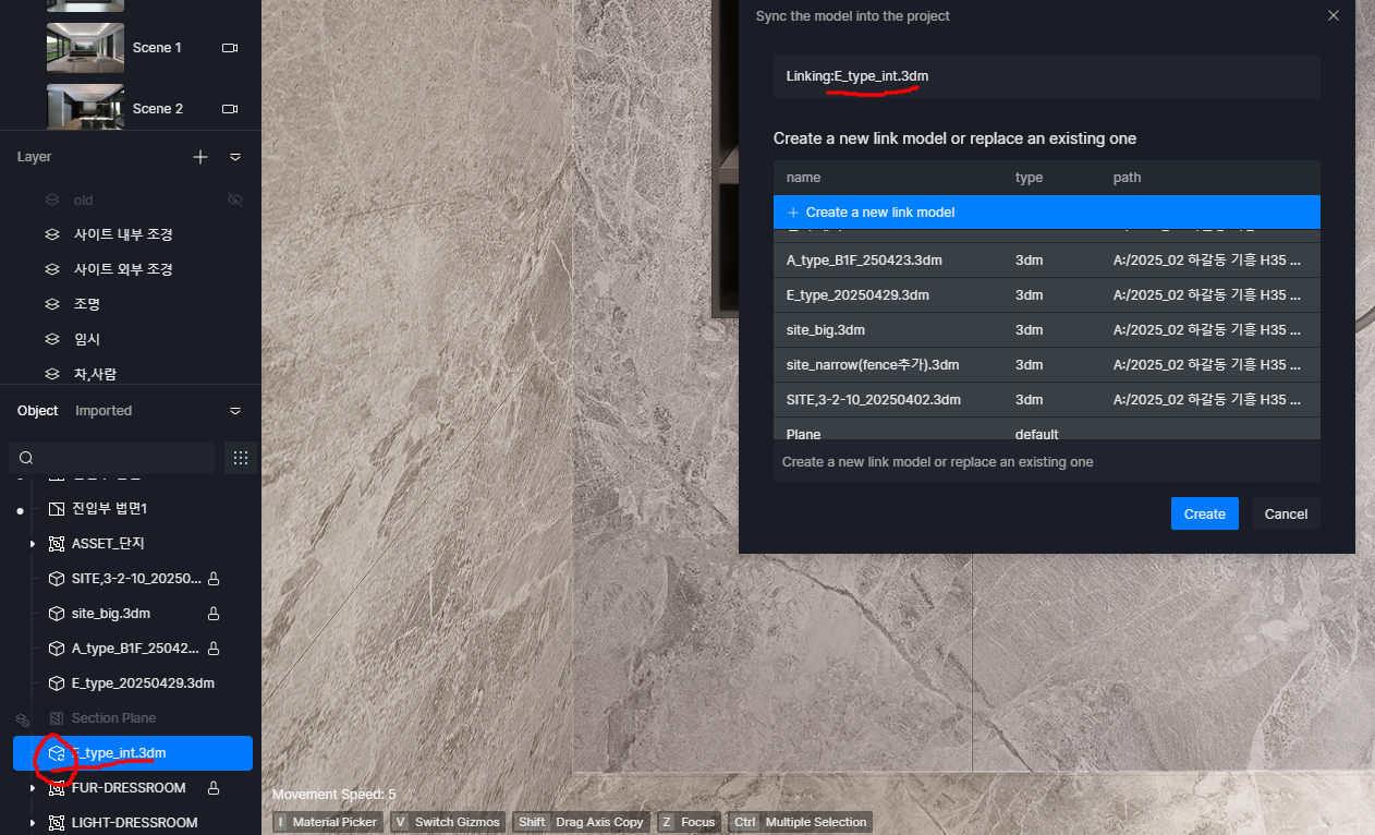

“I live-synced and mapped a model to D5 and saved it, but the next day when I tried to live-sync the file again, it didn’t appear in the sync list. I’m wondering why this issue occurs.”

  • Are you using a cloud storage to store this file? If so, please download the model in your local file path first.
  • Did you perhaps change its file location?
