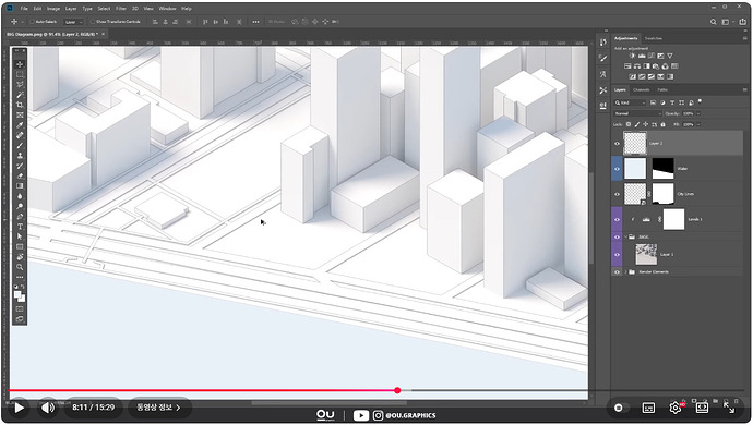

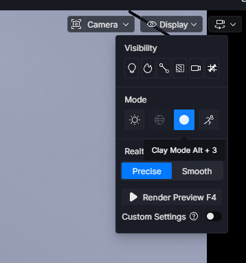

Previously, I used V-Ray’s clay render mode to generate a separate shadow image that could be layered directly beneath the linework. I’d like to achieve a similar workflow in D5, where I can produce a clean clay or shadow-only render that aligns precisely with the Rhino Make2D drawing, similar to the reference images below.
Image from Upstairs youtube
Hi @cyh21534
For better alignment with D5, please try:

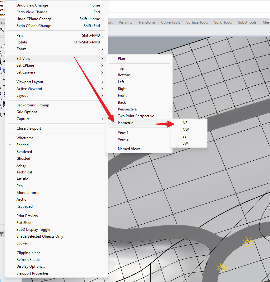

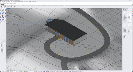

  1. Set Rhino to your desired isometric/axonometric view .

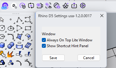

  2. Use the latest D5 Lite for Rhino plugin to synchronize the view to D5.

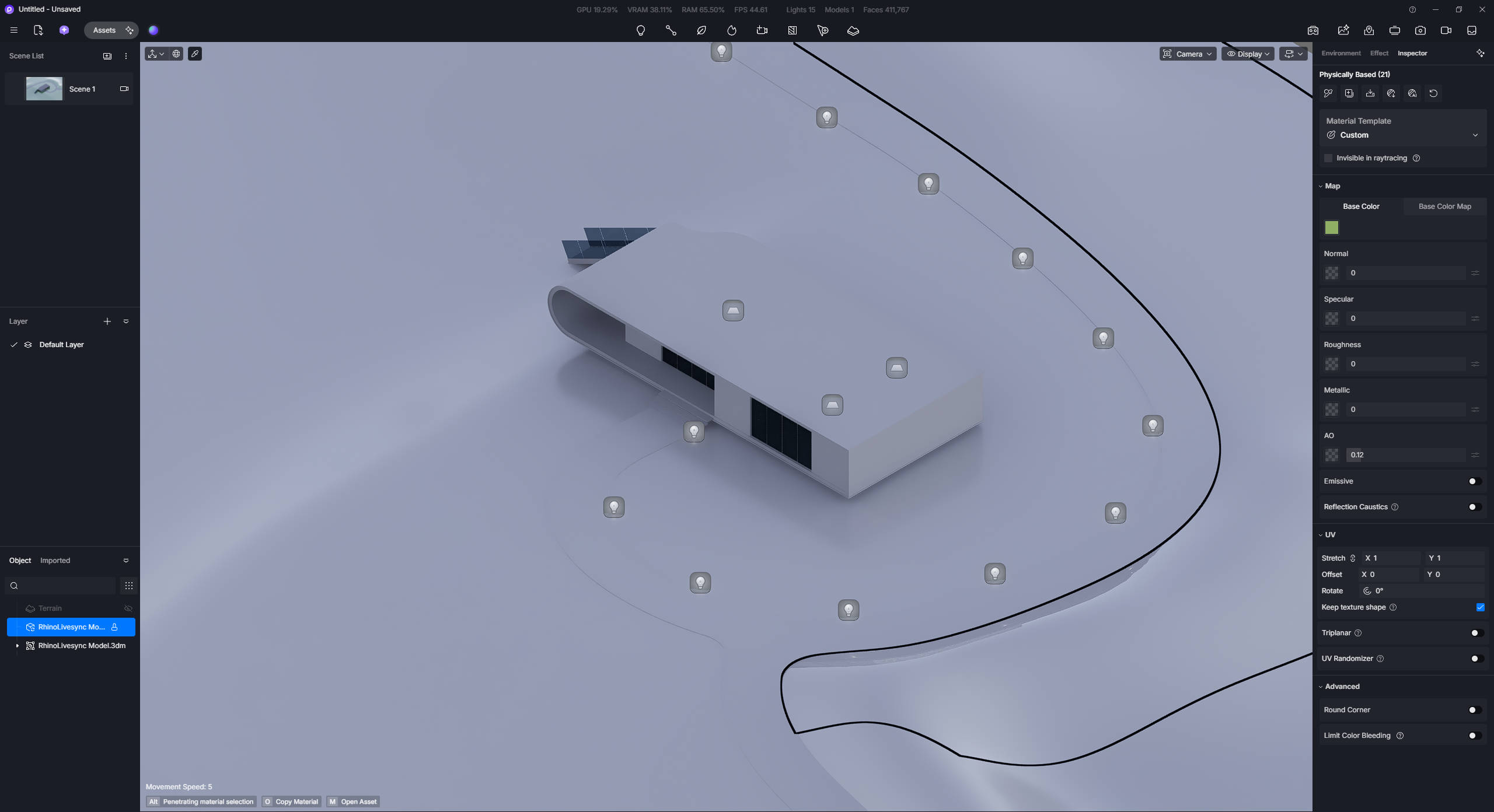

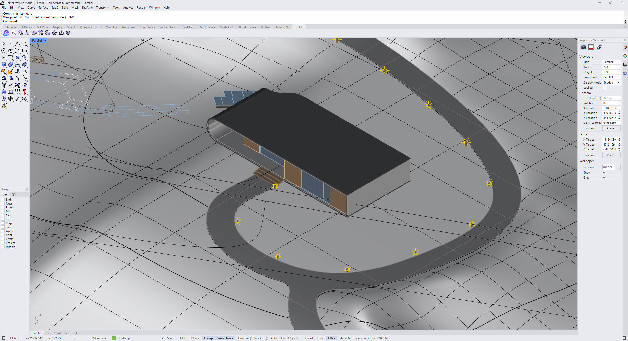

  3. In D5, switch to Orthographic mode and adjust the orthographic settings to match the Rhino view.
If the alignment is still different, could you send us a short screen recording of your workflow, including the Rhino view/Make2D settings, D5 synchronization, camera settings, and how you overlay the result in Illustrator? This will help us identify where the angle or scale difference is being introduced.
If your goal is a pixel-perfect overlay, the key question isn’t simply whether the cameras are synchronized. You need to ensure that Rhino Make2D and D5 use the same projection type, camera/view direction, framing/scale, and image aspect ratio.
