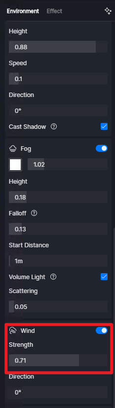

Hi @ESD
Trees move in the presence of Wind, try to modify Wind Strength in D5.
THANK YOU
that was the issue
why is this not mentioned anywhere is beyond me, its so silly
