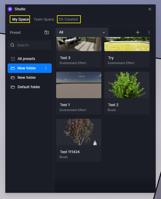

Thanks for your update. D5 Studio encompasses the different contents you have downloaded in this portion, including the enhanced images from the AI Tool.
- As you have done, deleting previously enhanced AI images should help, but is not limited to it. If you have a lot of content that you have put in My Space & D5 Curated, you may remove it too (if necessary)
