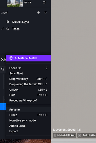

You may press right click on the “xxxxxxsuir.skp” which will prompt this pop-up menu
You may now then click delete in order to remove the Skp model.

? :face_with_head_bandage: for some reason …i dont see that option.
You may need to disable live sync mode by clicking this here:
Then the delete option will be visible.
Cheers,
Aryan

Hi there,
Upon checking after Clicking the Non-Live sync mode, may you please move the scene/Model a little bit. Then the delete option will now show.
It might take a little longer depending on how heavy the scene is.
Let me know if it works for you.
Cheers,
Aryan
ok bro… move not applicable with linked file… but yeah i tried visibility ON/OFF then waited a bit… the DELETE` menu showed up… thanks…
