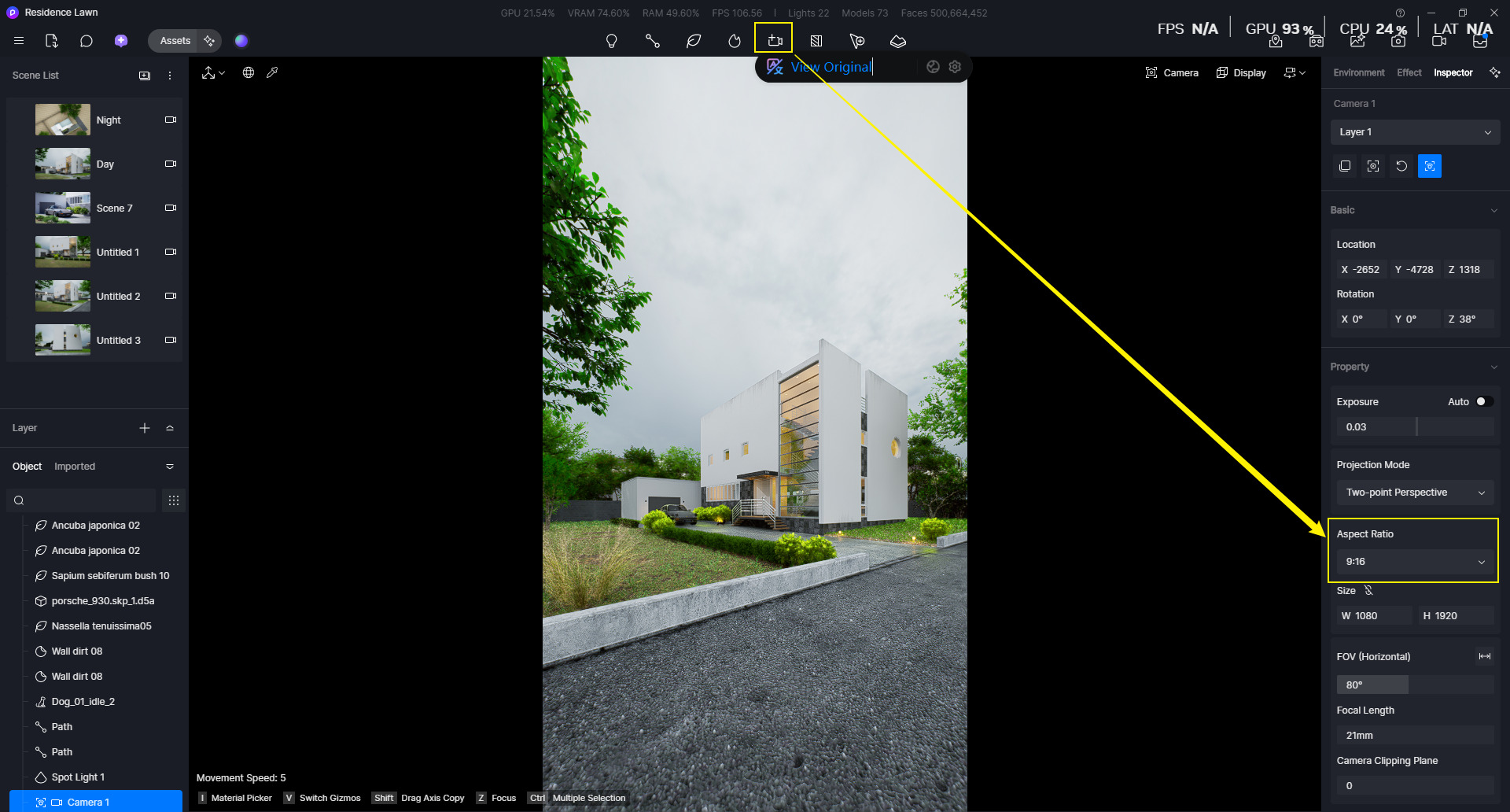

i was trying to make the shade darker, so i am not distracted by the surrounding scene/objects,
how to do this?
i cannot find option to set the side darker, now it semi darken, but i can still see the scene outside the frame…

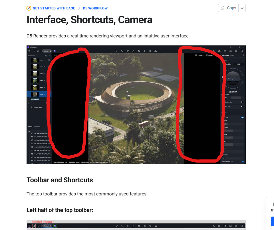

Hi @tommy
There’s no option to modify the colour of these sides. I also tried it on my end, and it is displaying the same black colour as the image that you sent.

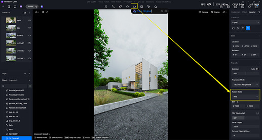

hi Clov,
thank you for the explanation, apparently i have never set the camera properly,
what i normally did was, directly set scene, then straight away go to render…
that’s why the border was always half dimmed…
Thanks,
Tommy

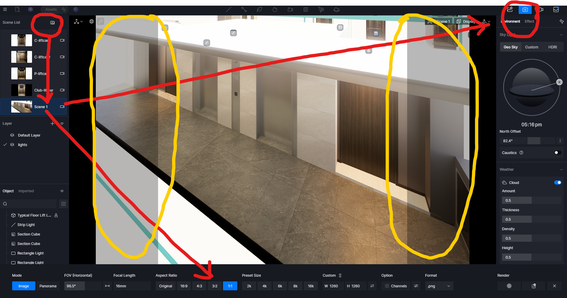

Hi @tommy
Alright, thanks for the clarification. Using the advanced camera tool will have these sides have a darker color compared to as setting it in image render.
