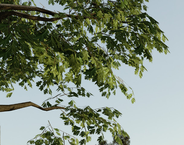

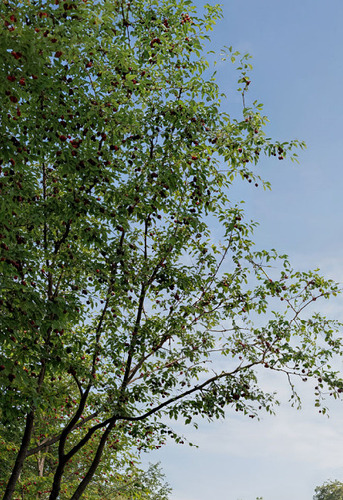

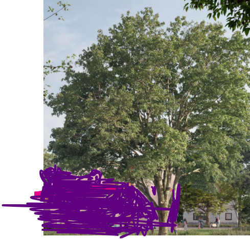

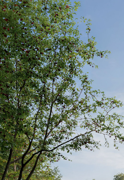

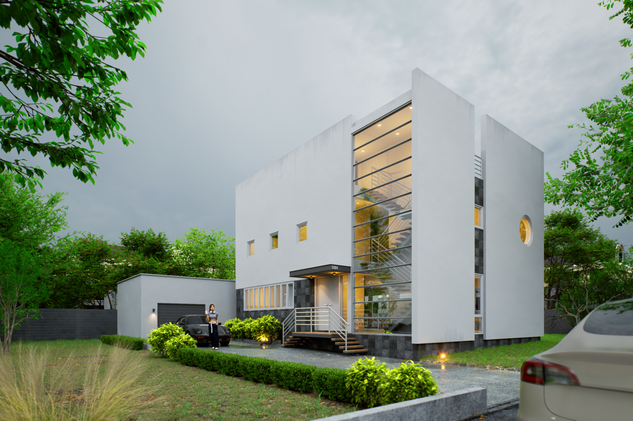

I am working with D5 render for a while, since I find the bushes & flowers are in good quality but I couldn’t find any trees in the library that can achieve this kind of realistic (the images below are from a render). I only need few models of tree which can be used in D5 with high realistic quality. How do you guys do it? Do you import it from another source? I would like to know what is your working method.
Tree in D5 render:

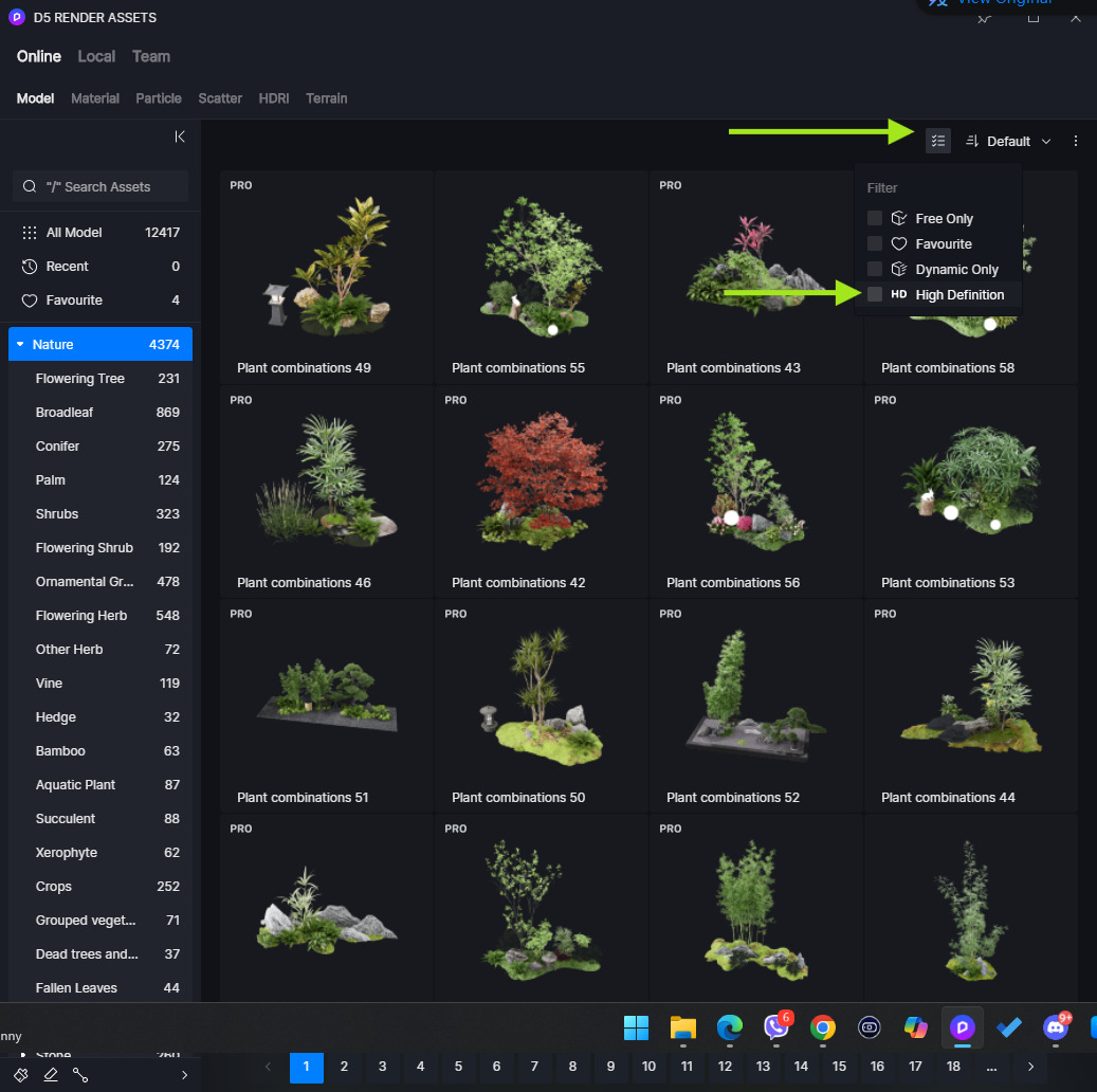

for good trees close to the camera’s go to the filter. and select high defenition. or type HQ/ HD
Hi @minhha20011
You should try @3d-ontwerp-visualisa suggestion, we do have a set of Trees or vegetation assets that are labeled as “HD” or “High-Definition”. Ofcourse, using this asset would also contribute to the heaviness of the file since it is more detailed so you may use it carefully~
Thank you, I will try them out. I haven’t noticed that there is an option to check for HD objects
