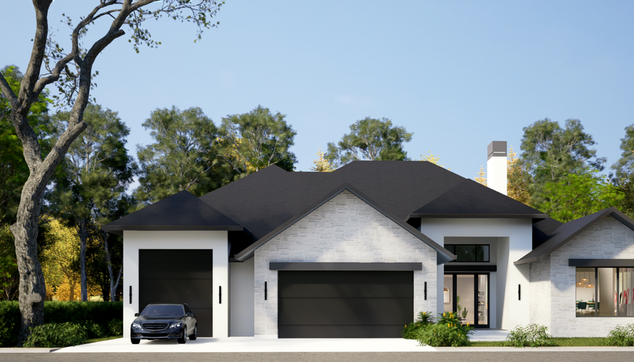

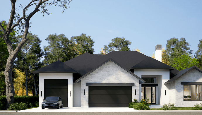

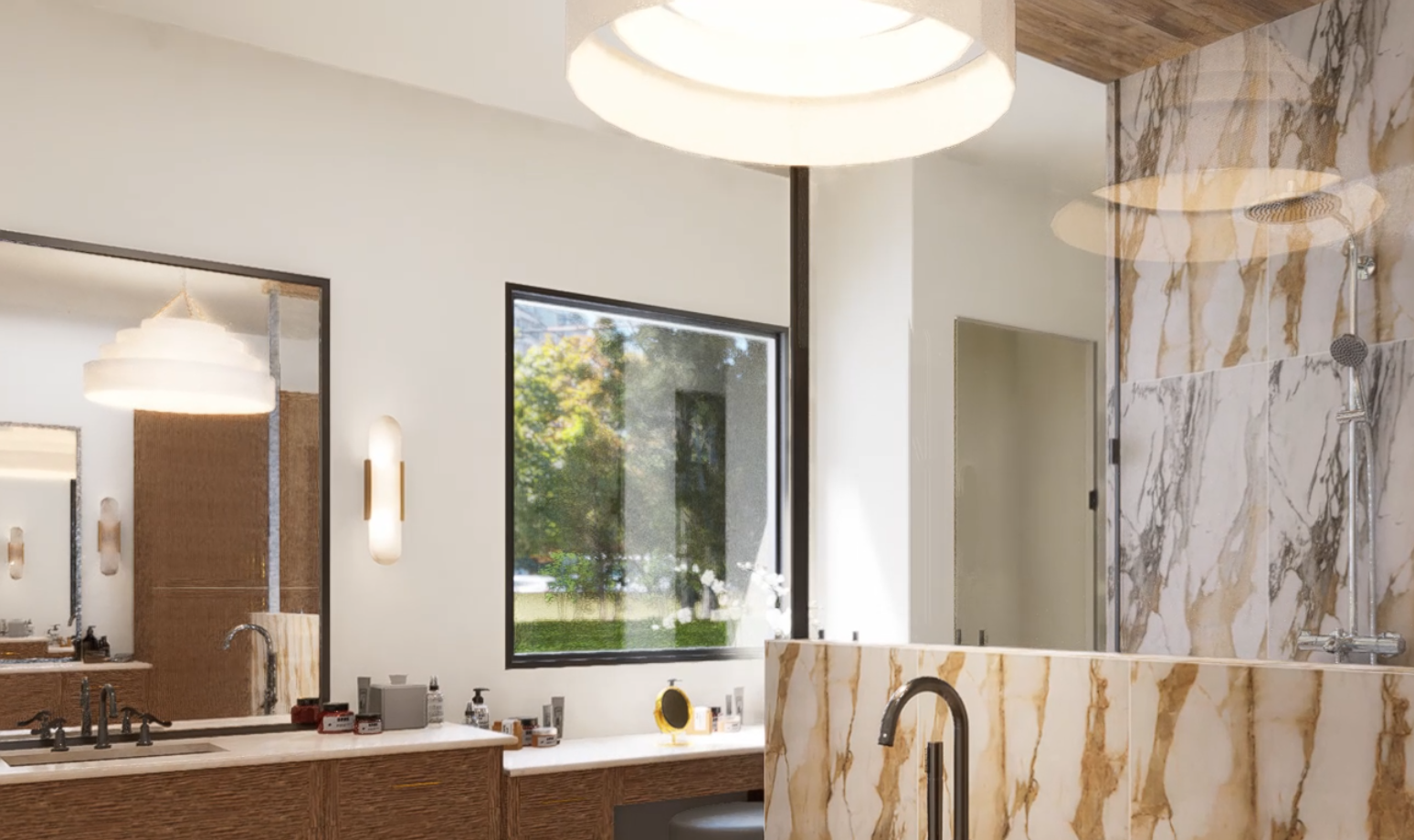

Hi. I am facing an issue from the time I started using D5 animation. I think the problem is now getting acute. The issue is I am getting flickers in interior dark corner areas and ghosting with moving object mainly with the movement of trees. I am attaching some files. Please let me know how should I solve this issue.

Please also note that I turned of super resolution, frame generation, FPS booster, DLSS and LOD. I always render with image sequence 30fps, 1080p resolution

Thank you for sending the videos. I just checked it, but I don’t quite see the concern that you’ve pointed out.
  • Ghosting - Can you elaborate further on this? I’ve only observed Vegetation movement because of the wind.
  • Noise from animation - I assume this was present on the interior video. Have you tried modifying your scene’s exposure, lighting, etc.? An area with not much light may have a lot of noise in the final render.

As for the “ghosting” movement, you might want to try disabling these settings:
  • Cloud
  • DLSS-Super Resolution
I’m guessing the user who made that video has their settings at maximum. Perhaps in 4k Quality and 60 FPS, another possibility is utilizing Sequence export instead of video. It might actually be best to ask for the user’s video settings and tips, since I’m just guessing their setup up :joy:
