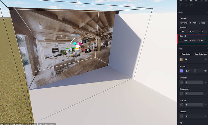

Put any decal in the assest → model → decal section. Then change the texture with the image you want, then delete the texture in the opacity section.
I tried it, see if that is what you want? if not, please specify your desire.
This is just one of many ways, I need to know what picture you want to put on the wall to be able to help you accurately. Thanks
