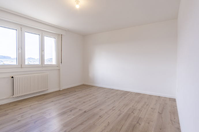

I would like to be able to do some home staging (adding 3D furniture to an existing photo like this one below).
What is the best method to do this on D5?
How would you do to get the right angle, shadows etc.?
Thanks for your help and have a nice day !

Yes, of course, but what about the right angle, the shadows etc. ? Can we display the photo directly in the viewport background on D5 so that we can rework it like a layer?
I’m sorry, I didn’t understand your question. So the photo you sent is actually just a 2D background image, not a 3D model, right?
Exactly ! And my client want to put some 3D furniture on it :slight_smile:

Just use the AI of the latest Photoshop version! :laughing:
I would just model the room working with d5, the photoshop solution will not be able to
produce correct shadows.
You can use modeling, but the lighting and image quality (effects) will not match the original image. If I were the client, I wouldn’t accept that.

Kinda depends if you really want to be sure that the furnitures are ok for the room the original photo is not really relevant. What really relevant is are the dimensions and the materials of the existing room including windows and that can be modeled.
