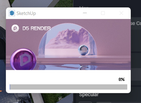

HELP ME. D5 converter not respond after update
before update don’t have problem ,after update can’t use sketchup D5 converter
Hello kettisaklove, Please close SU then reinstall the SU plugin from our official website:
Download | D5 Render
I think you were editing several SU files when it updated the plugin? This may cause update failed, sorry for that.
Please let me know whether it can work now, thank u.
