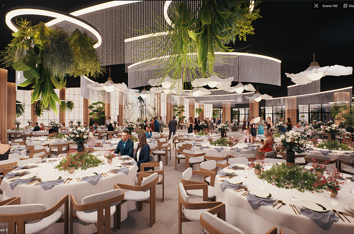

when i set the scene, and i get the atmosphere that i want, the render looks different than the preview that i worked , and i want that the render to keep the atmosphere that i set

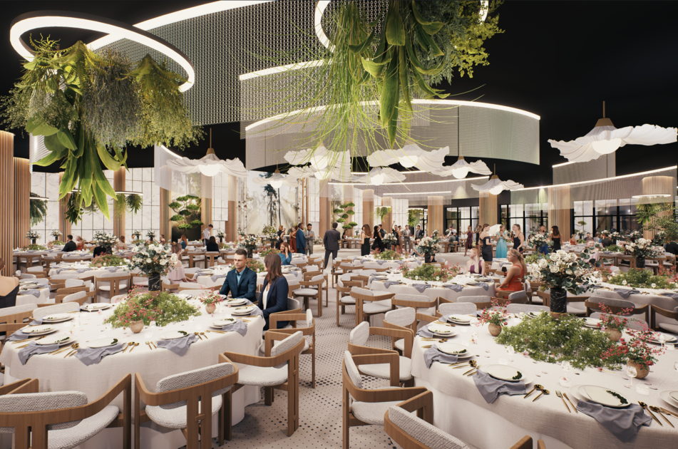

the first image is the preview, and the the render looks more green than it should be

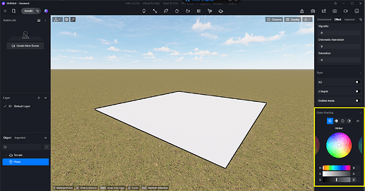

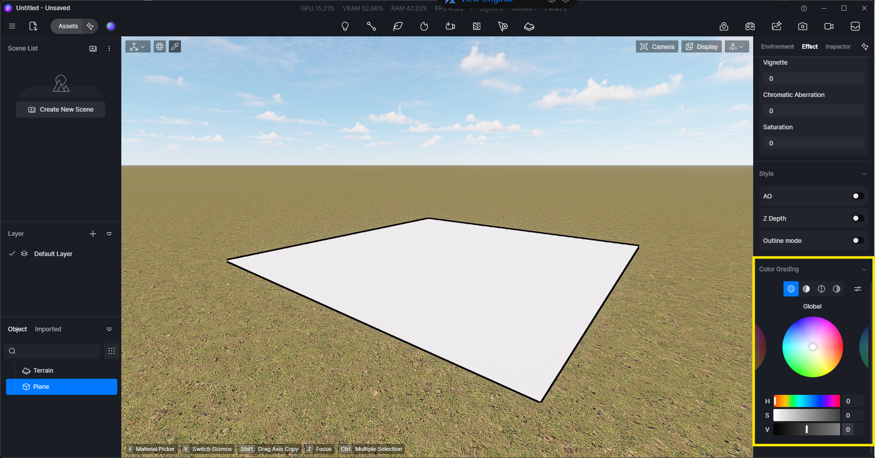

- Did you enable color grading?

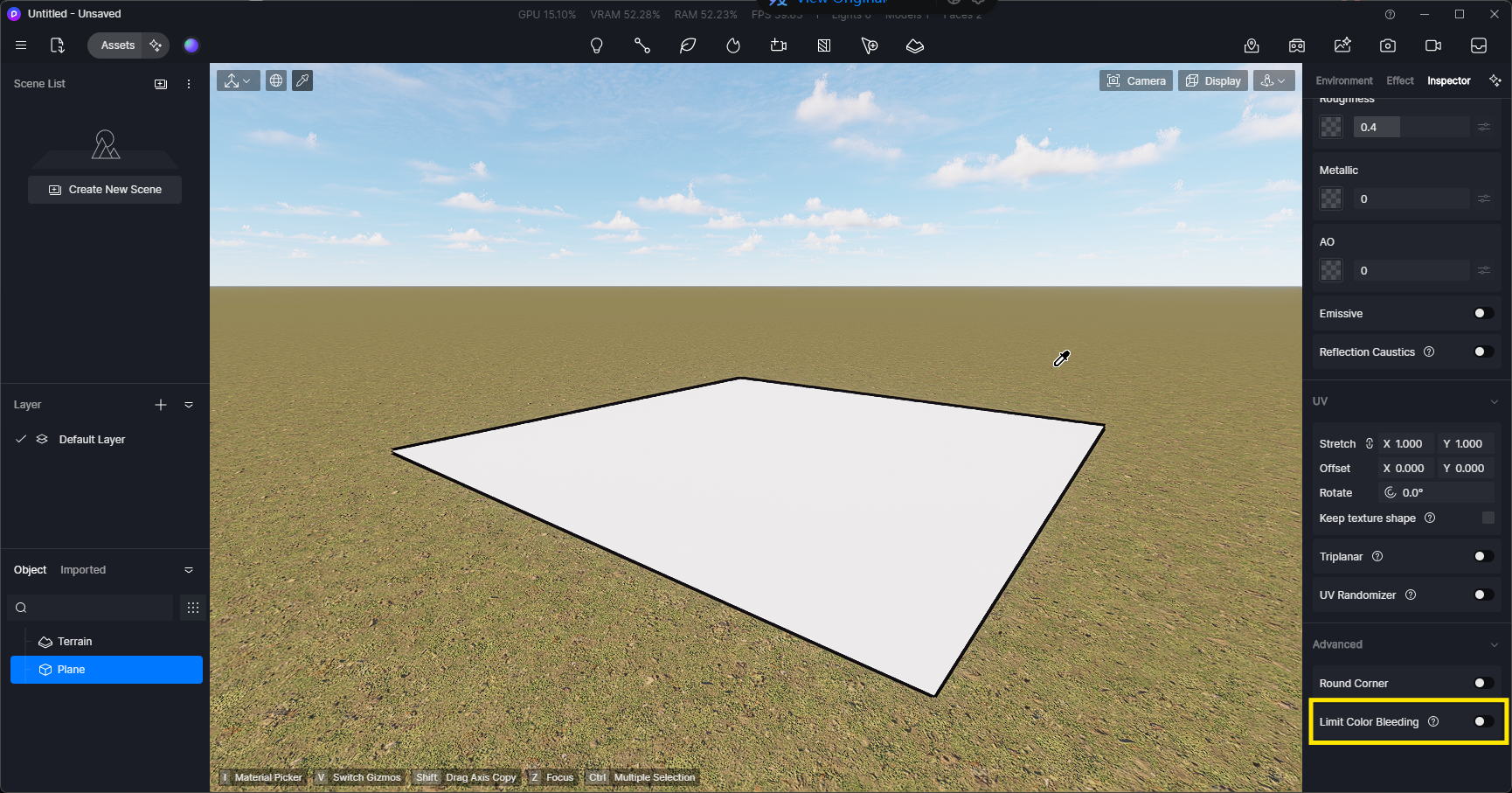

- You may also want to enable “Limit Color Bleeding” option on the materials that appear “greener” on the final render.
