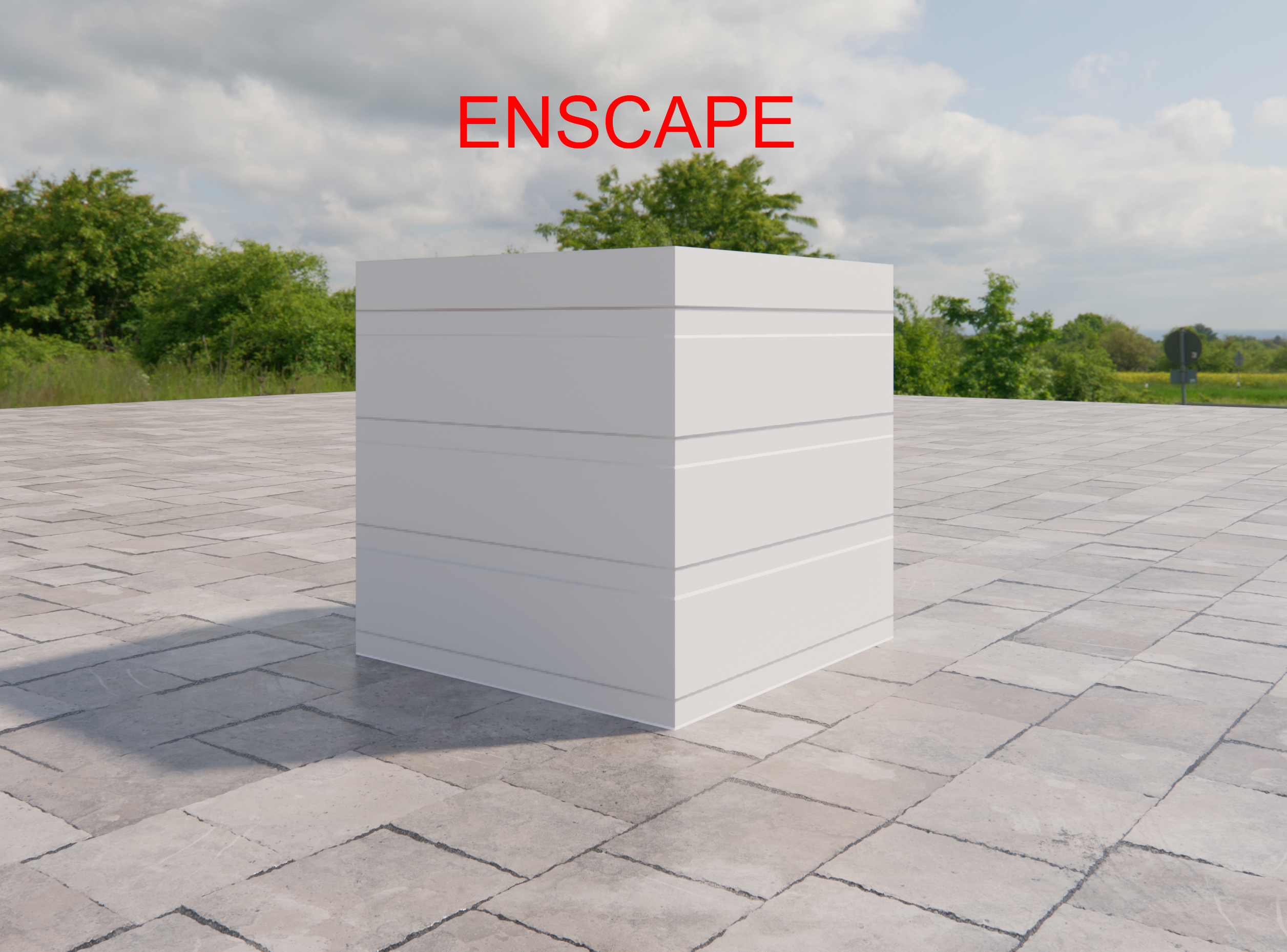

In enscape you have an empty diffuse slot, load up a bump map into the height map and get either a bump or displacement effect true to the bump map with the material being just the generic colour in the diffuse.

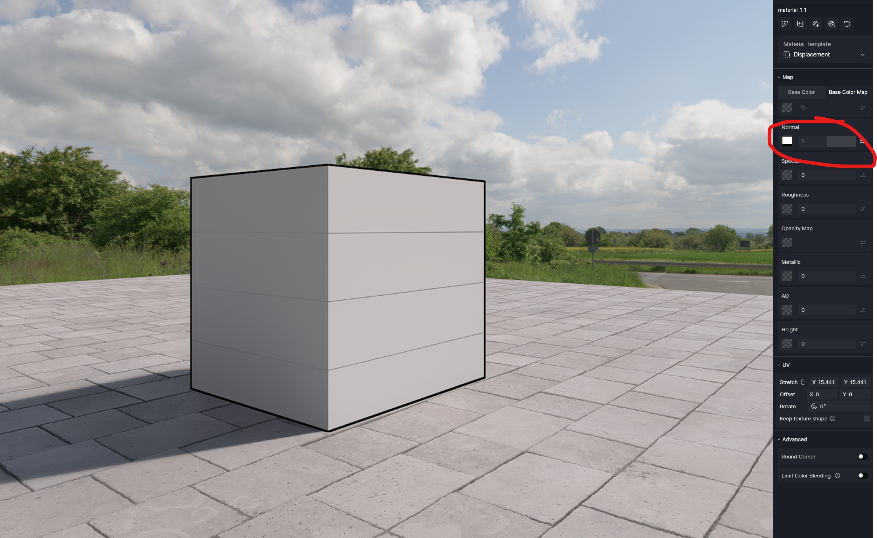

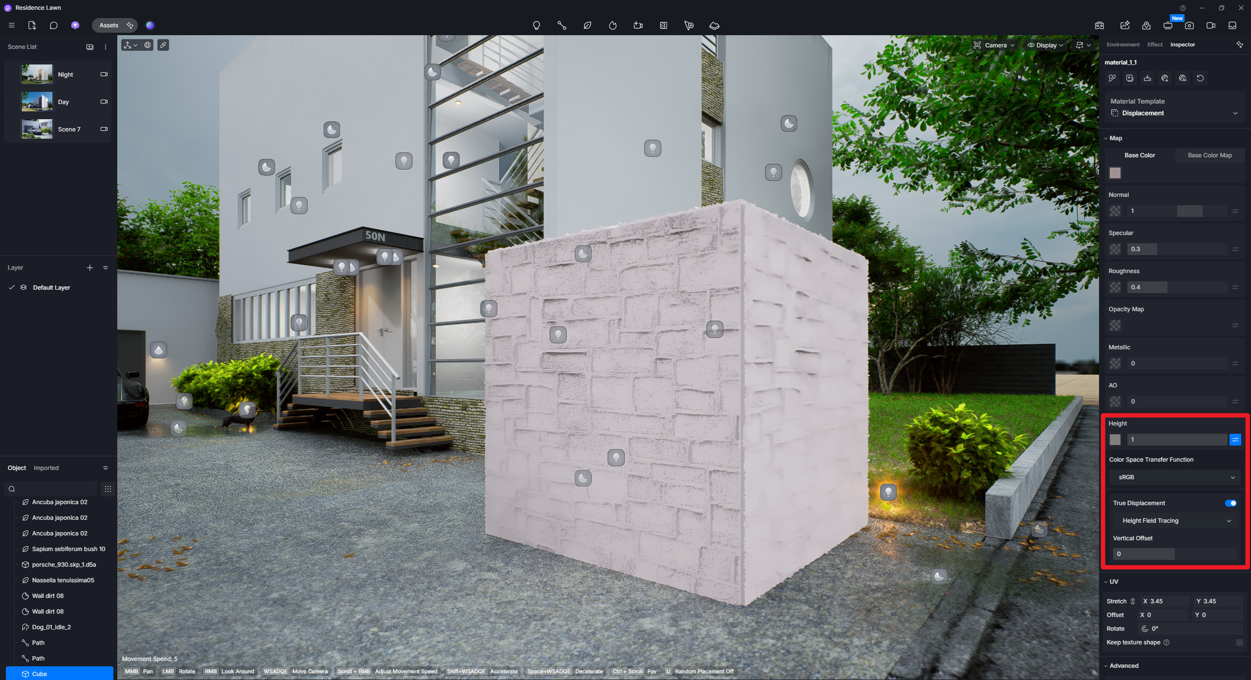

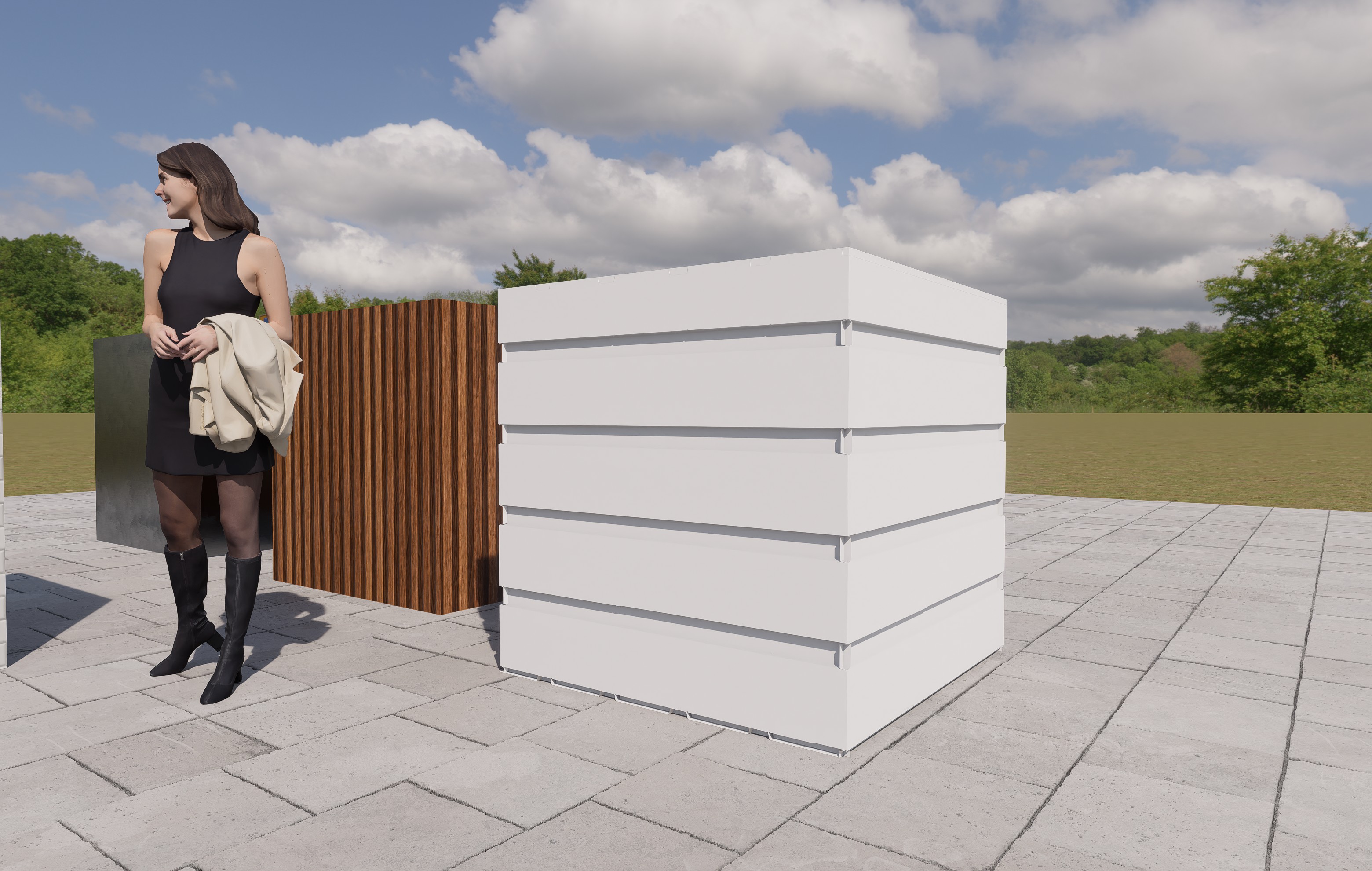

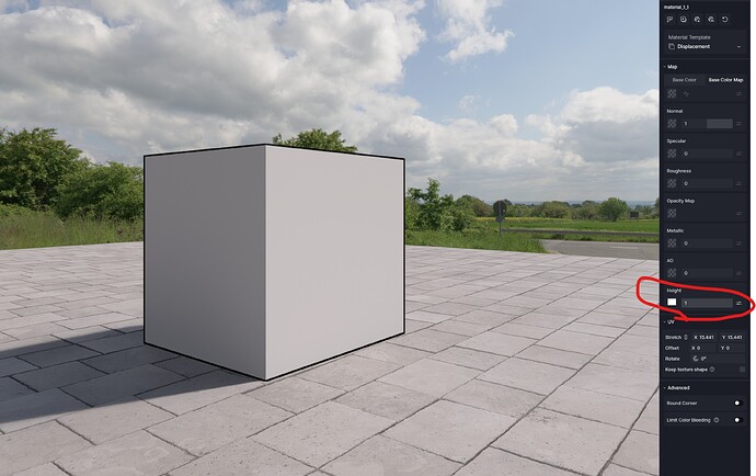

In D5 If I load a simple linear bump map into the height slot, it shows nothing, no matter what scale. If I load it into the normal slot, it has some effect but it does not scale as per the bump map I loaded. The only way I can get just a bump to work is to toggle on the true displacement but whether i’m using subdivision or height field tracking, the corners of the geometry will never perfectly align or clean up no matter where I set the vertical offset. This is a real issue for clean geometry like timbers boards or siding. You can get away with it on really rough natural materials like stone somewhat.
If I can load jpegs here I will show you what I typically get from Enscape VS D5. The bump map is a simple black and white line where the black is approximately 1/4 vs 3/4 white in thickness

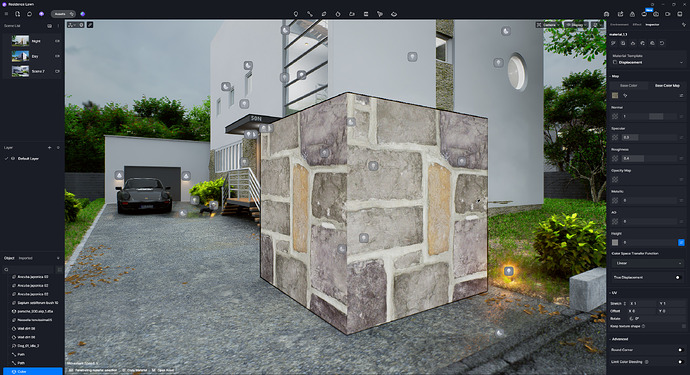

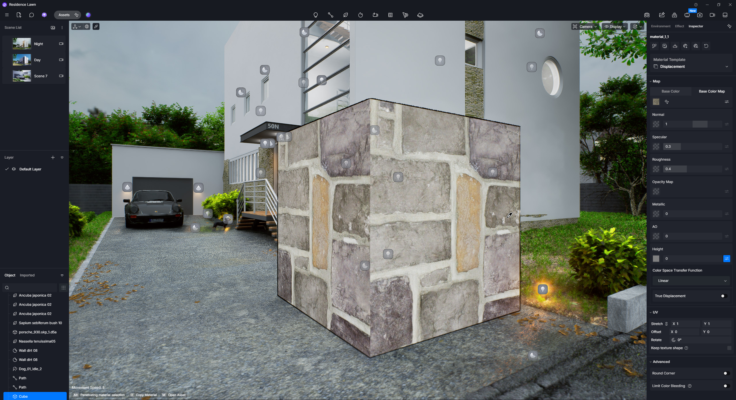

The key difference is that D5 Render uses true displacement rather than a parallax or bump approximation. Because of this, the Height map is directly tied to the Displacement feature and is intended to modify the actual surface geometry. As a result, loading a height map by itself will not produce a visible bump effect unless displacement is enabled.
  • Unless the Base Map is loaded with the texture, the displacement can function without toggling true displacement.

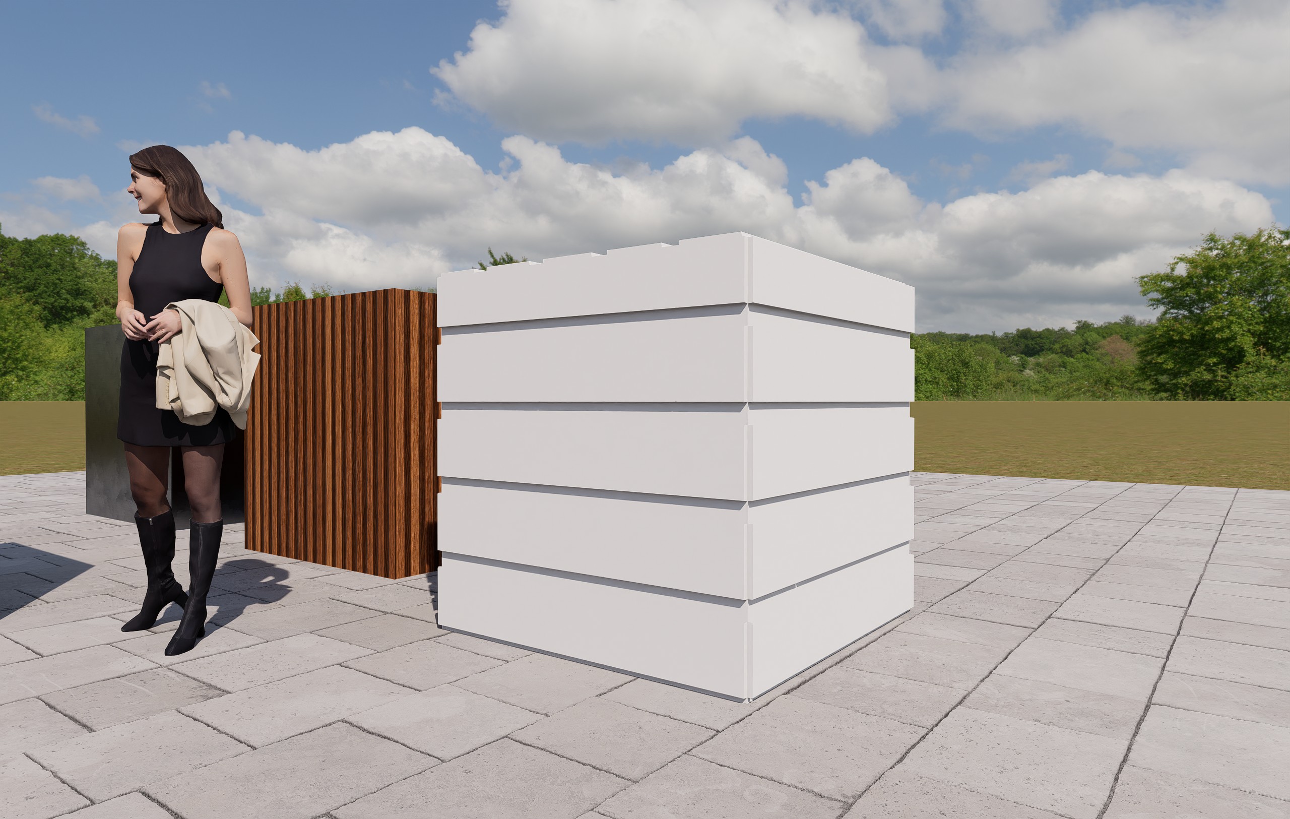

At least I know how it is intended to work. I actually often prefer a bump / parallax version for most my materials as i don’t have to worry about the external corner junctions.
The true displacement is great, especially the new geometry light version. Its just a shame that it doesn’t work great on external corners with clean geometry (works pretty good with stone etc). So Again, im going to need to revert to modelling the planks or modelling corner cappings.
