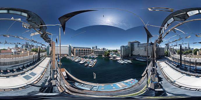

So I’m wondering if there’s been any progress in improving them. I’m testing out some workflows where I’ve created a HDRI 360 image. I’ve then upscaled this using AI so it’s cleaner. However, when I export, it’s blurry.
Anyone have any ideas? I’ve tested it from 2k-8k with the same results. I’m going to have to photoshop things into the backdrop, but it would be great to be able to set it up and not have to worry in D5.

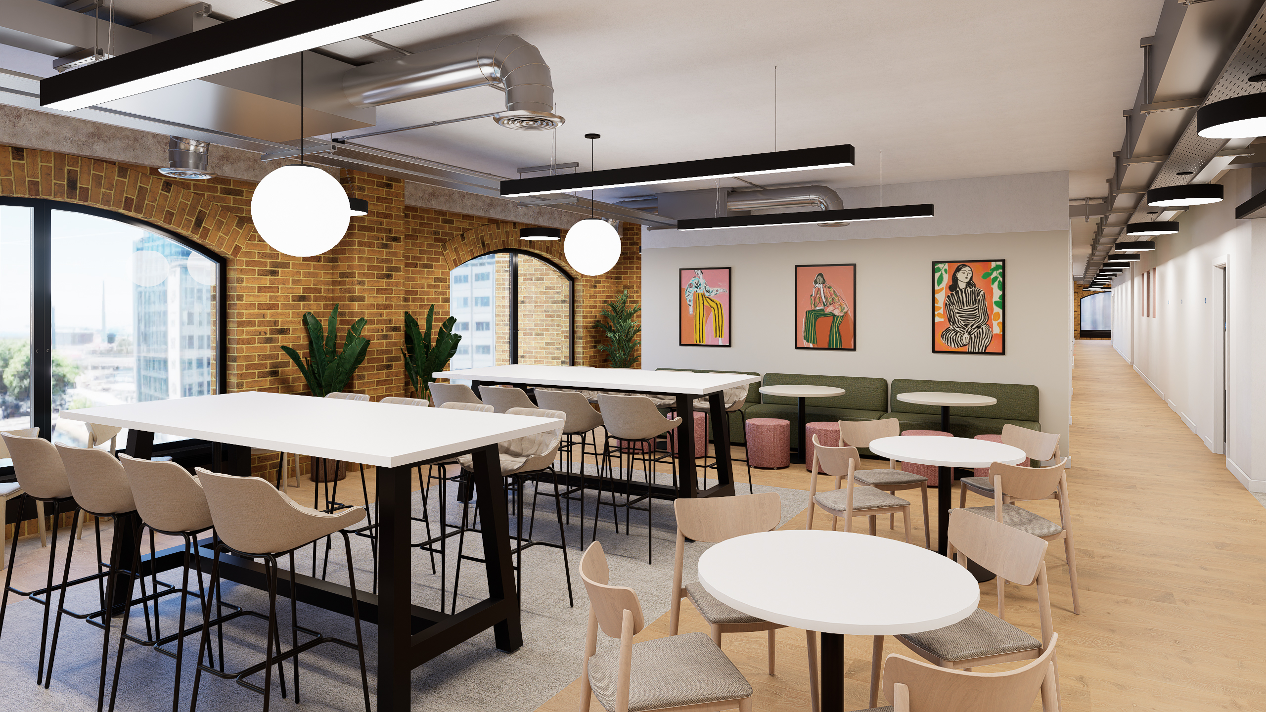

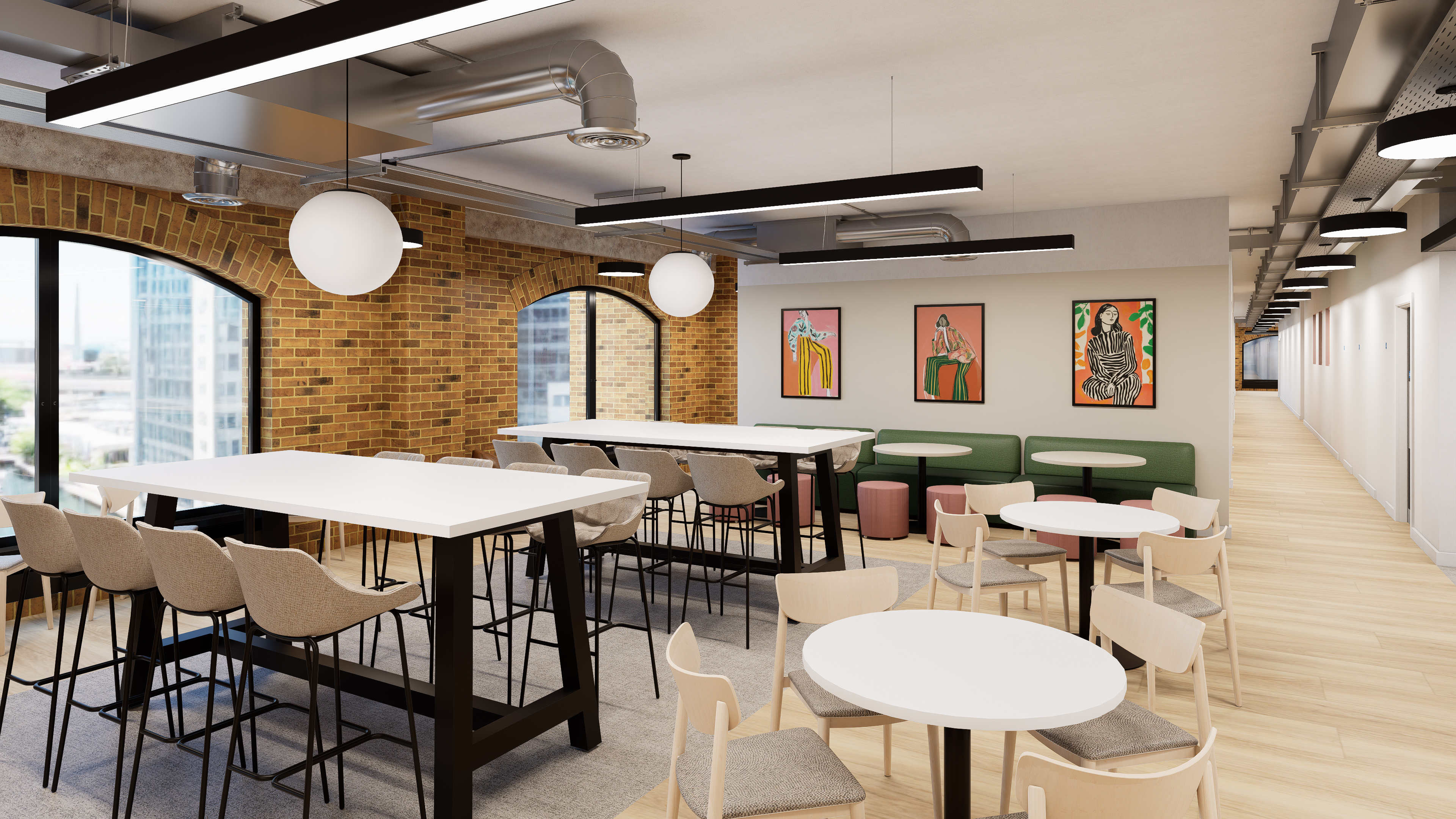

That’s the problem the quality doesn’t seem to improve, the image I’ve attached is the render test and the 360 used.
So I did a little test this morning, I created a Sphere and then applied the HDRI image to this. It seems that doing this actaully improved the quality. I will have to set up two renders, and then mask this through the windows, but the quality is a bit better. It’s still not amazing. Would love to hear any further thoughts.

Can you share the HDRI File? You may generate a link containing the zipped HDRI file so I can test it on my end. Thank you.
Hey, here is link, it’s not super high res, but even so it’s odd that I can get a better result mapping it to my own sphere.
