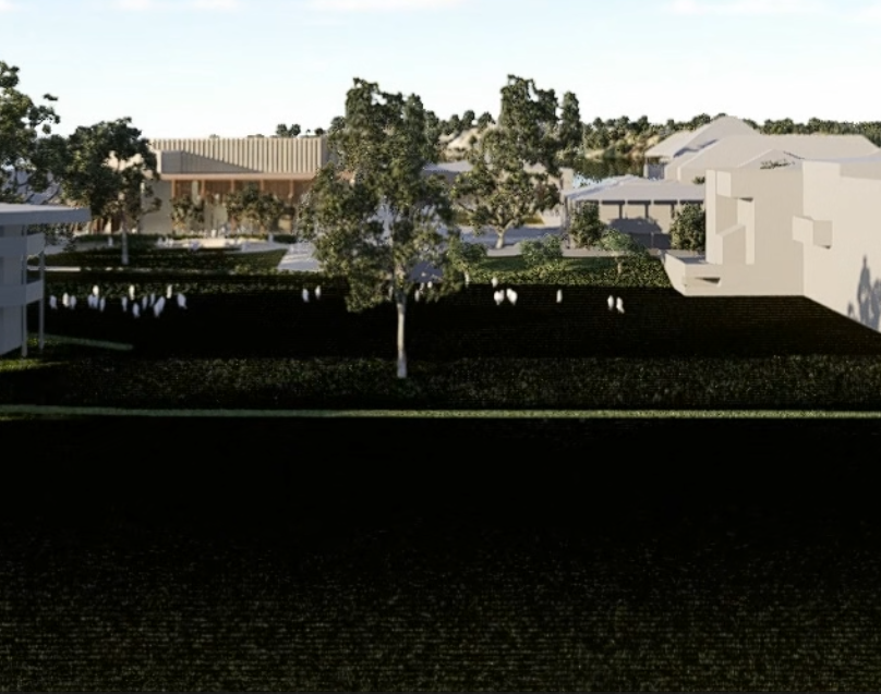

I have had an issue where rendering animation the grass flickers back as the angle lowers down. I have tried disabling D5 SR rendering, Super resolution, Frame Generation, LOD and other things which could lead to this issue but it still seems to happen.
Hello, @kheng apologize that this is happening to you. Is this the only specific file that you have trouble with? What D5 version you are currently using? Is your scene close to the origin (0,0,0)? Models that are too far from the origin are tend to have flickering issues. Did you check if the grass in that area is duplicated? Lastly, try rendering it on a higher resolution. If the flickering problem persists, you can send your file scene to support@d5techs.com put the complete forum link, and tag me @maslu for easy tracking. Thank you for understanding and supporting D5.
we tried to render last night at 2k 60FPS last night and it seemed to have solved the issue. not sure if it was the frame rate or the increased resolution but there is no issue luckily . Just in time for the deadline!
