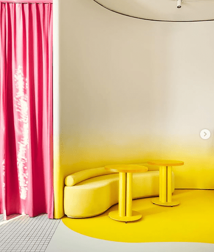

Hello, how can I create a gradient color with D5 rendering?
Hi there,
We currently don’t have a material in our D5 Asset Library that is specified to have this gradient effect in a solid wall (wall paint), we do have a gradient class. Regardless, you can recreate such effect by either:
- Inserting a Gradient Color Map (jpg or png)
- Using the Gradient Decal Asset and change the Base Color Map to your desired color.
thank you, but it’s not enough. I would love to see this feature in the next update so that we can make designs like this.
Hi there,
Thanks for the idea. I’ll share it with the team and we’ll see how we can incorporate it.
You could create this specific gradient in photoshop and use it as base color in D5
