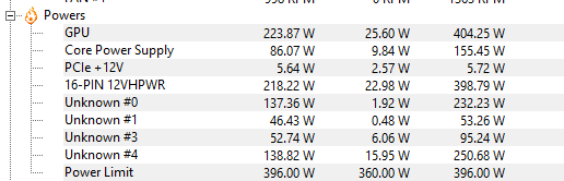

Been testing a new system build and am watching temps, power etc while running various benchmarks. I noticed that D5 is not using the full power draw I’d expect from the GPU being fully utilized and am wondering if there is performance being left on the table?
Screenshot below of the power draw during the benchmark (values on the left) 1080p video render export, which for me finishes in 58s. Drawing ~230W during export, whereas on the right you can see the MAX value I got from running Furmark benchark a few minutes prior, which is expected.

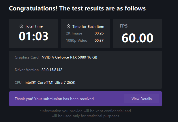

Yes, I have used the benchmark tool and performance seems about in line with others with similar hardware. I’m just unsure why GPU usage shows 100% but power is much lower. It’s not seemingly stressing the GPU very much vs other heavy 3D applications.

I’ve consulted with the team regarding your question about D5 Render’s GPU usage. D5 Render does not always use your GPU’s full power output in simple D5 scenes, and this is completely normal.
The GPU utilization percentage (which is directly proportional to its Power Consumption) you see isn’t always a direct measure of performance; it’s a measure of how busy the GPU is relative to its current workload.
It is the GPU driver that decides how power is used. The driver, with your operating system (OS) and the API (such as DirectX or Vulkan), continually manages the GPU’s power state.
If your scene is simple, the driver knows it doesn’t need to engage the maximum clock speeds or wattage to maintain a smooth framerate (or to complete the render quickly). It scales the power down to save energy and reduce heat.
If you have Vertical Sync (V-Sync) enabled or have the application’s frame rate explicitly capped (e.g., to 60 FPS), the GPU will not push to 100% because it knows it has to wait for the monitor’s next refresh cycle.
