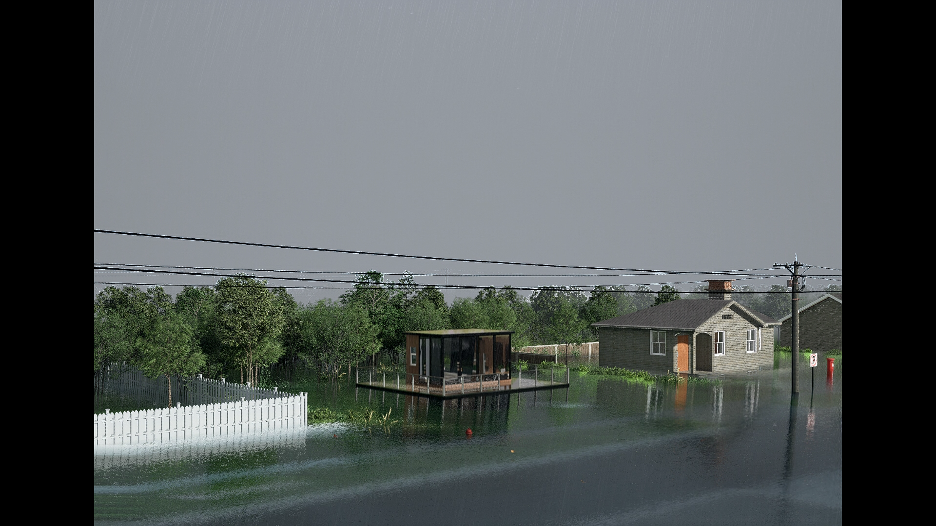

I’m encountering a strange visual glitch with the trees in the background of my scene when performing a walkthrough, and I’m hoping someone can help me diagnose the issue.

I’ve already tried with and without Super Resolution and FPS Booster, but the damn glitch still appears in the final render. This issue only shows up in the final render, in the preview window, there seems to be no problem at all.
I also tried to simulate climate change by transition from sunny to overcast conditions and added fog. I think that might be the issue, because when I rendered it using only an HDRI, there was no problem. But, I want to create this climate change animation and I don’t know how to solve this problem.
