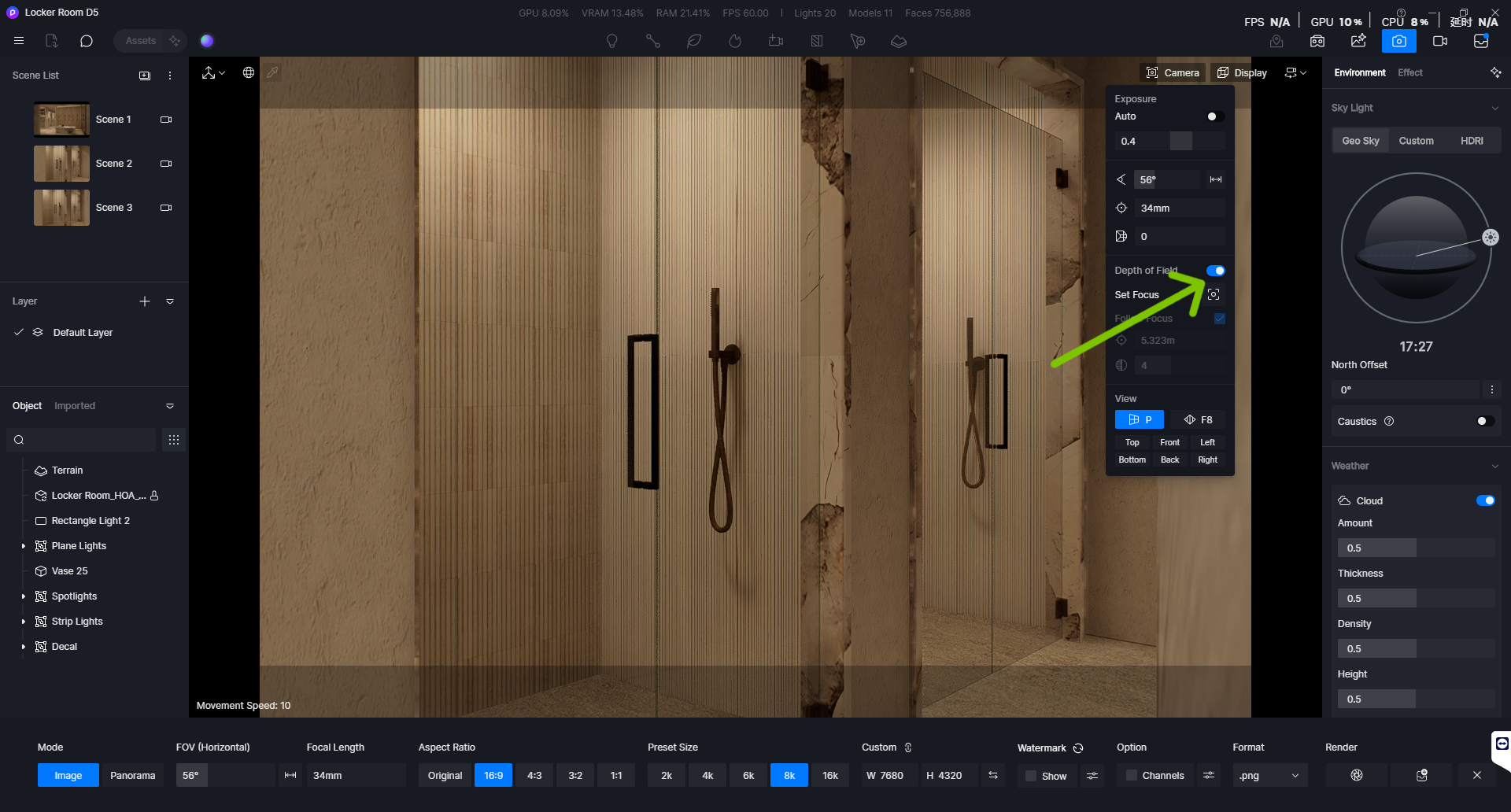

We’ve tested your file. I tried rendering 8k Images with different angles, focusing on the glass that has an issue but there are no “cloudy” or “blurry” effects on my end.
Results: Unique Download Link | WeTransfer
  • Please try to disable Depth of Field in your camera and try to render it again.
