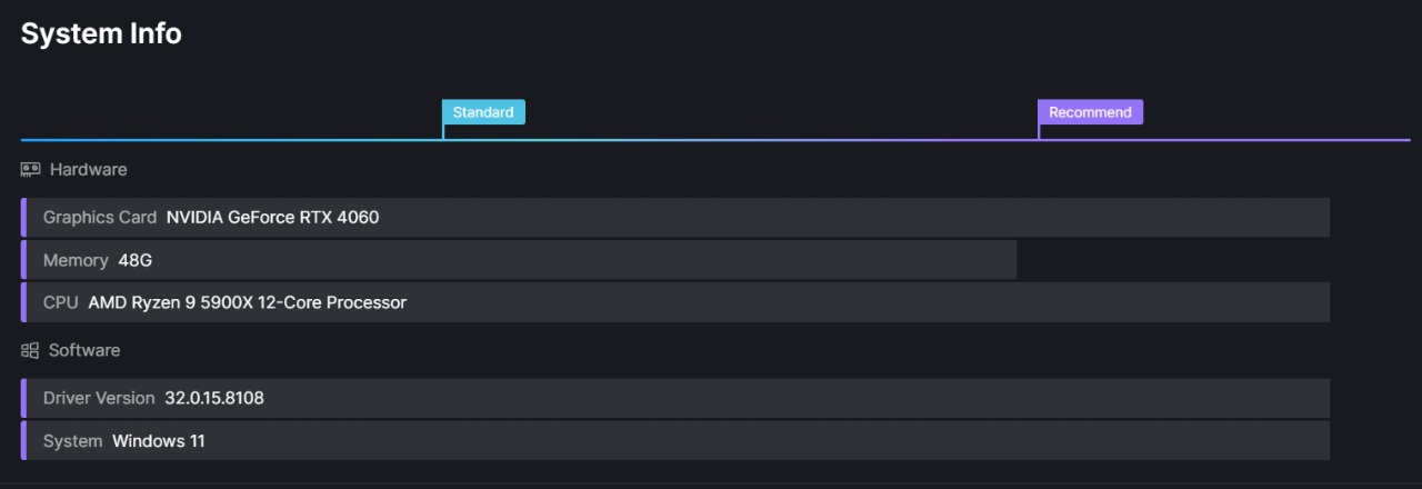

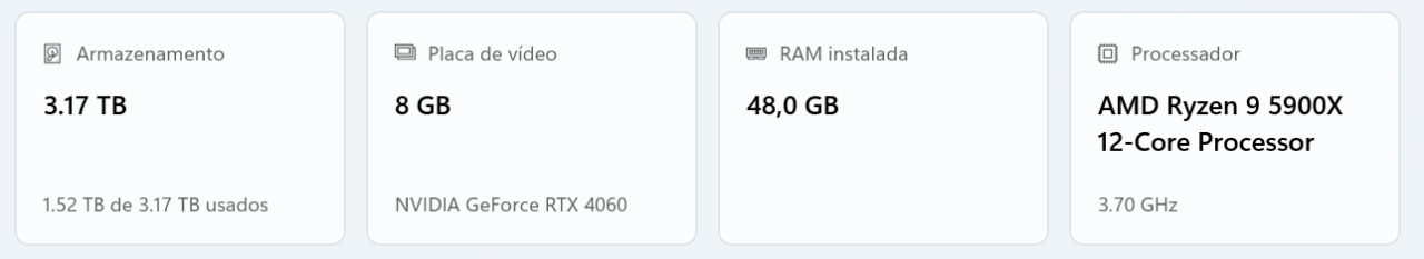

Specs:
Ryzen 5900x
48GB DDR4
GTX 4060

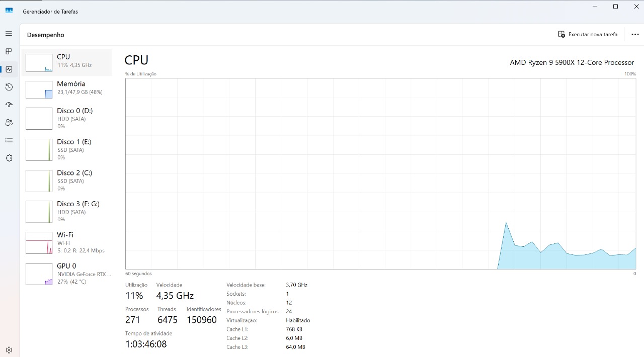

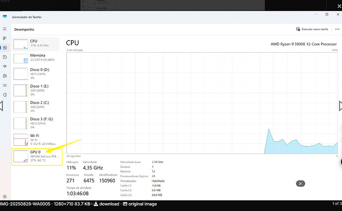

Working with complex files is dependent on your device’s VRAM capacity. Please send us the following images:
Please confirm or answer the questions asked
File optimization is essential when working with large files, most especially when it involves a lot of scatter or vegetation assets. An 8GB or 12 GB VRAM may be insufficient, and even 16GB VRAM if it is really massive. Updating your Drivers should also help.

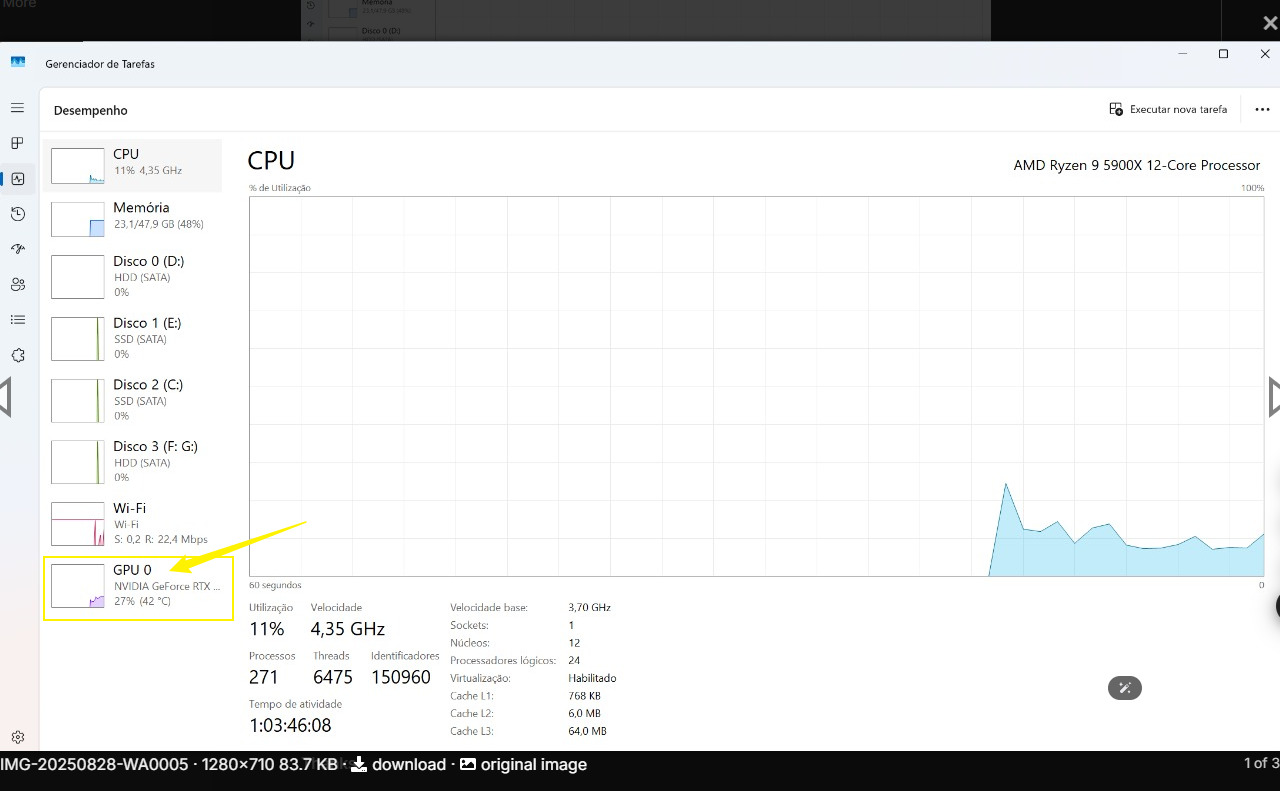

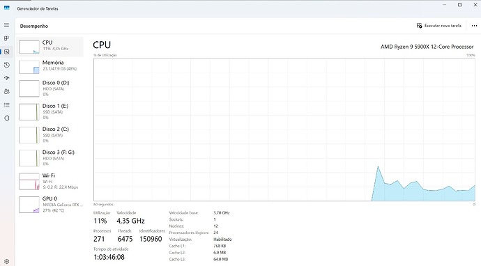

Hi @andreyreifuralves
Please click GPU 0 not CPU, you may refer to the image I have provided above. Thanks.

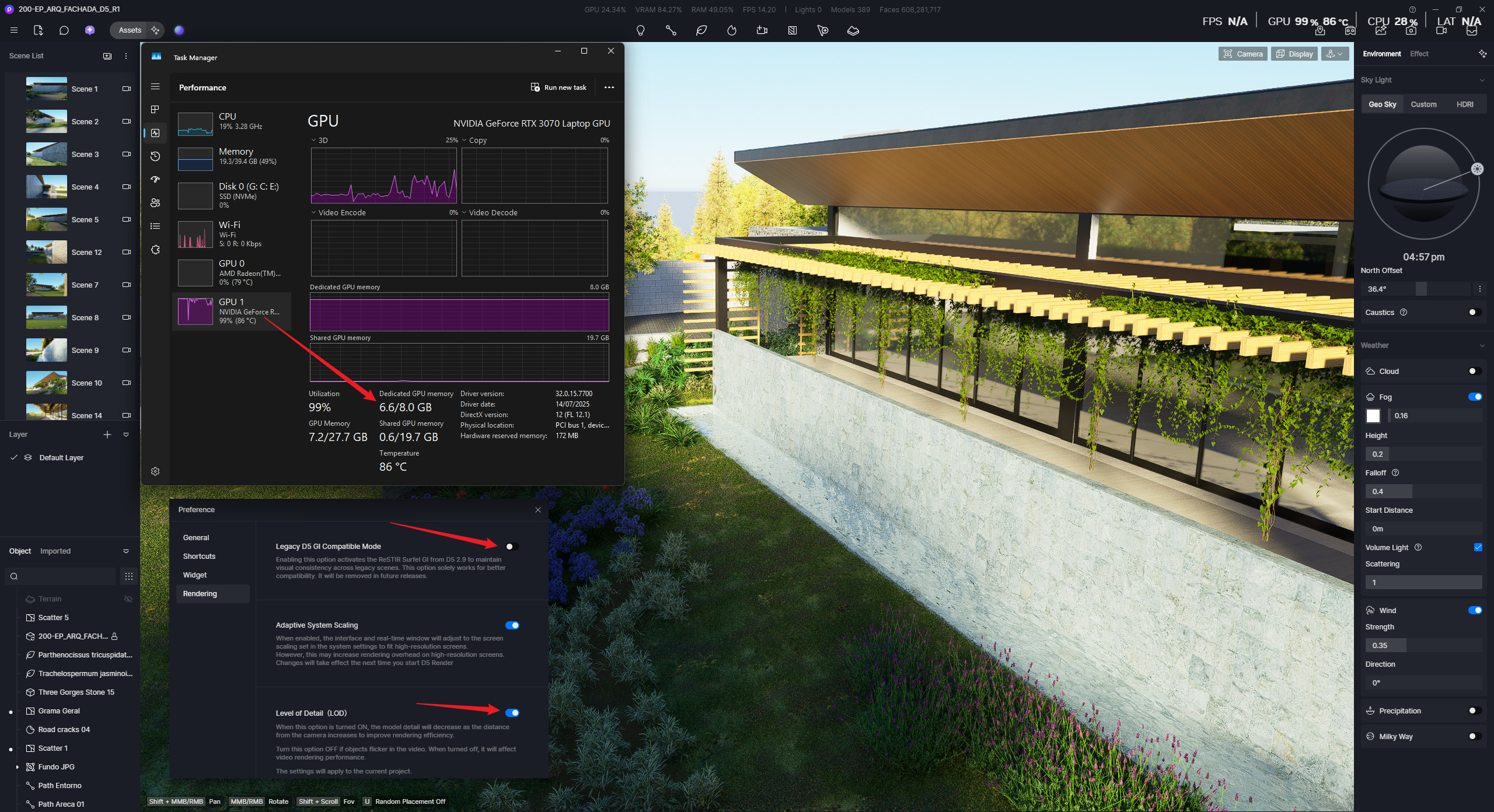

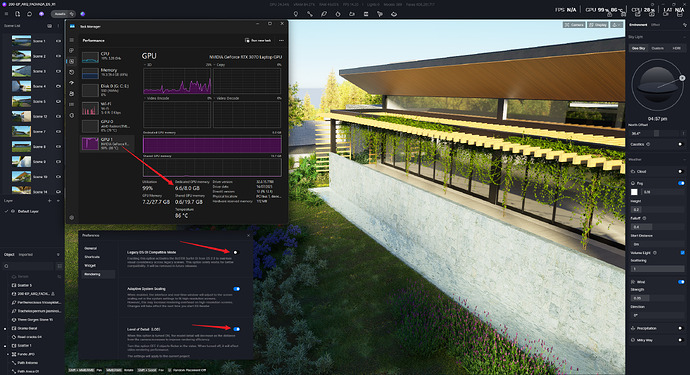

I am able to open your file using an RTX 3070 Laptop with 8GB VRAM. I have enabled the following options to minimize lag and further consumption of VRAM:
  • LOD - Enabled
  • Cull Distance - Enabled
  • This is a PC Device or is it a laptop device?
  • Just to clarify, you’re using 2.11.0.0605 or 2.11.0.0603, right?
  • Can you generate a log file? This seems abnormal considering that your file was opened with a much lower device spec. Please send it to me privately here in the forum so we can proceed with further troubleshooting and investigation of this issue.
